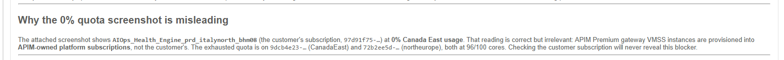

    Thank you, Mohammad! This explains random nature of HTTP 400 however APIM team needs to take further action to increase compute quota. There is no action on customer side.

    The Azure API Management (APIM) VNet Injection update failed due to an Azure Regional Compute Core quota limitation in the Canada East region.
    During the update operation, APIM attempted to provision additional compute capacity. The backend investigation identified that the deployment was blocked by a QuotaExceeded validation error because the subscription did not have sufficient regional compute cores available.
    Quota Details:
    • Region: Canada East
    • Current Regional Core Limit: 100
    • Current Usage: 96
    • Additional Cores Required: 8
    • Minimum Required Quota: 104
    Since the total required cores (104) exceeded the approved regional quota (100), the deployment validation failed and surfaced as the UpdateApiServiceFailed error.
    Resolution: Increase the Regional Compute Core quota in the Canada East region to at least 104 cores (or higher based on future capacity requirements), or free unused compute resources in the region and then retry the APIM VNet Injection update.
