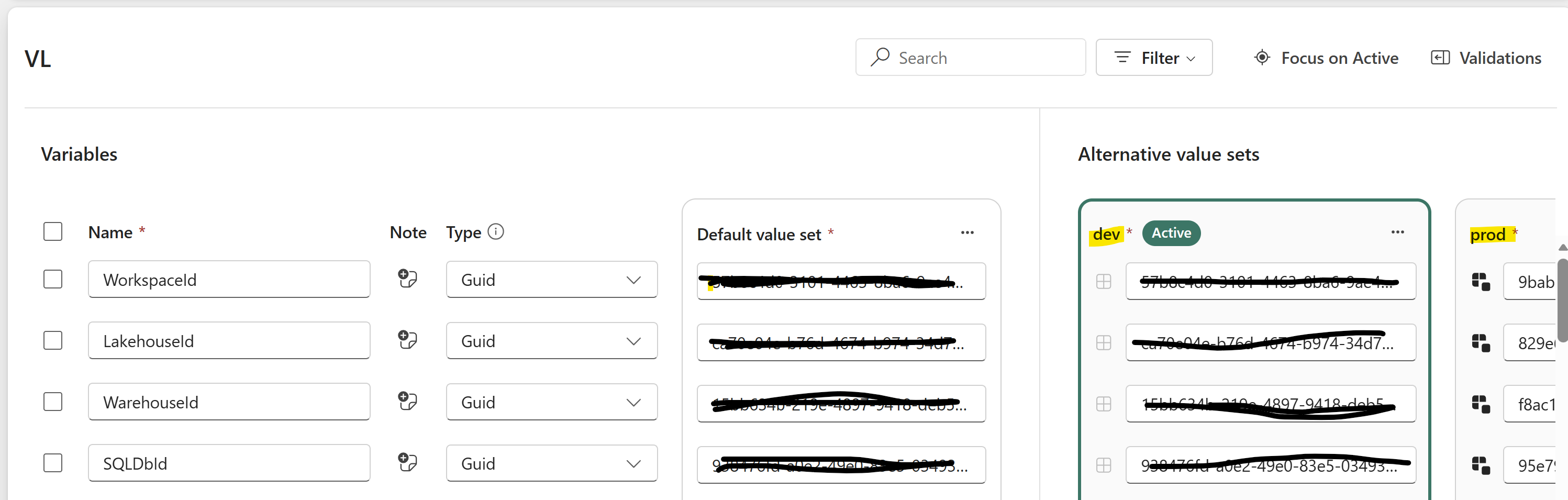

You would need to set up Variable library and set up the connection details and the default value set which would be 1 time manual across the workspaces:

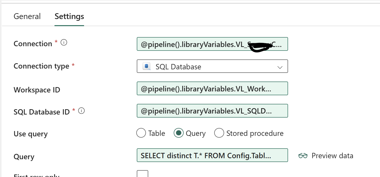

And then reference the variable library values across your connections :
This is the closest for CI CD.
