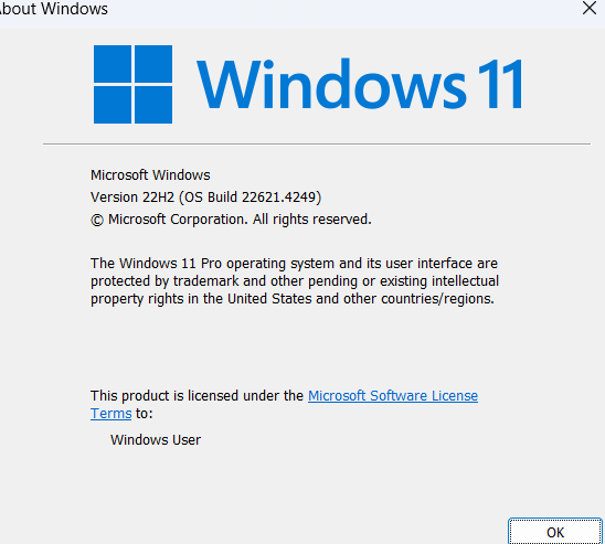

How to update my windows (update service is off, i do not have antivirus)
2026-08-19T06:38:26.89+00:00
update service is off and i can not start it error 1053 this request did not respond to the start or control request in a timely fashion widows could not start windows update i can not update windows as error encountered or retry
