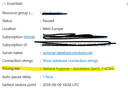

    In the portal, go to the blade for the database. You will see something like this:

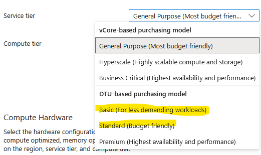

    Click on the text Serverless... This will take you to a page where there is a dropdown for Service Tier:
    Select one of Basic or Standard. Basic can be very slow, but an S0 or S1 should be OK (but less powerful to what you have now). Be sure that the lever for DTU is to left, or almost to the left.
    A DTU-based database is always online, and at the same time S0 and S1 are very budget-friendly makes you free credits last longer. If you only switch from Serverless to provisioned General Purpose, you will run out of credits quite quickly.
