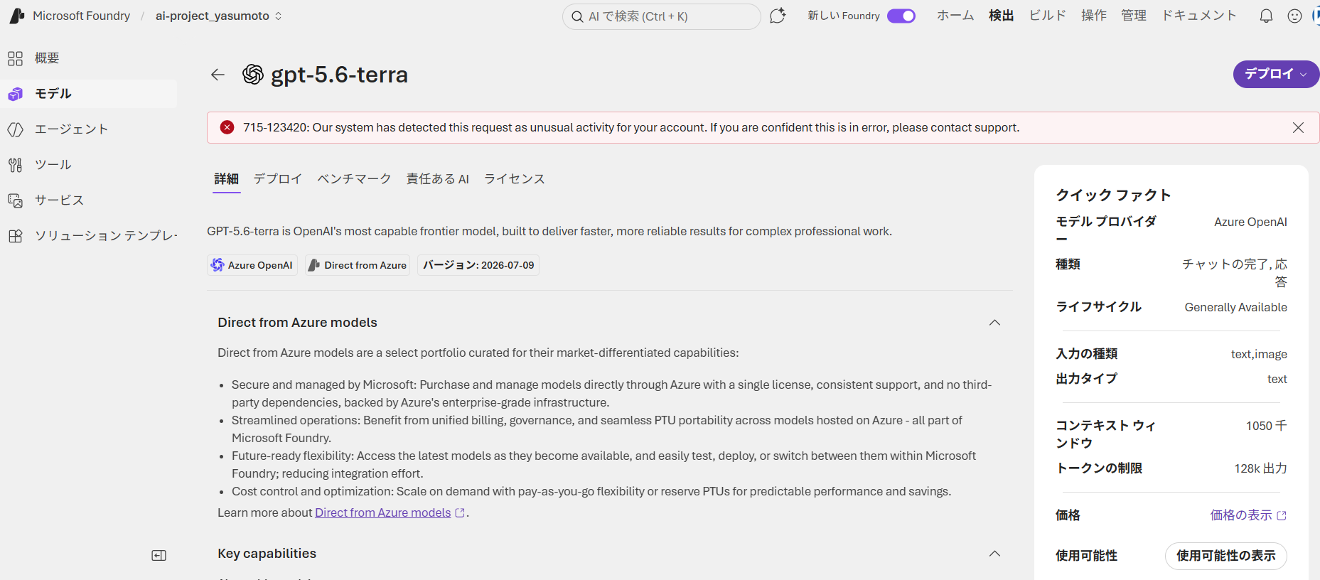

I am unable to deploy models in Microsoft Foundry.
Error:
715-123420
Our system has detected this request as unusual activity for your account.
If you are confident this is in error, please contact support.
I have already tested:
  • Different Foundry resources
  • Different regions (East US 2 and Japan West)
  • Different models
All deployments fail with the same 715-123420 error.
Azure Support informed me that technical support requires a paid support plan.
Similar Microsoft Q&A cases indicate that this error may be caused by
a fraud/risk signal and require backend review.
Could a Microsoft moderator please help escalate this to the appropriate
Foundry backend / PG team?
I can provide the following information via private message:
  • Subscription ID
  • Foundry Resource ID
  • Client Request ID
  • Trace ID
  • Service Request ID

    Based on what you've already tested, this does not look like a model, region, quota, or Foundry-resource configuration issue. You reproduced the same 715-123420 error across different resources, regions, and models.
    Microsoft moderators have confirmed in several recent Q&A cases that 715-123420 is associated with a service-side fraud/risk protection hold and requires review by the appropriate Microsoft internal team. It isn't normally something that can be cleared by changing deployment settings.
    I would not keep retrying deployments, recreating Foundry resources, or switching regions. Those steps generally don't remove this type of restriction and can make troubleshooting noisier.
    Since Azure Support is directing you to a paid technical plan, I would ask a Microsoft Q&A moderator to assist with escalation/private-message collection for the backend review. Similar 715-123420 cases have been handled this way when the customer could not open the required support case directly.
    You already have the right information ready:
    • Subscription ID
    • Client Request ID
    • Trace ID
    • UTC timestamp of a failed deployment
    Please don't post those identifiers publicly; provide them only through private message or a secure support channel.
    At this point, the next useful action is backend review of the subscription/account risk flag, not additional deployment troubleshooting.
