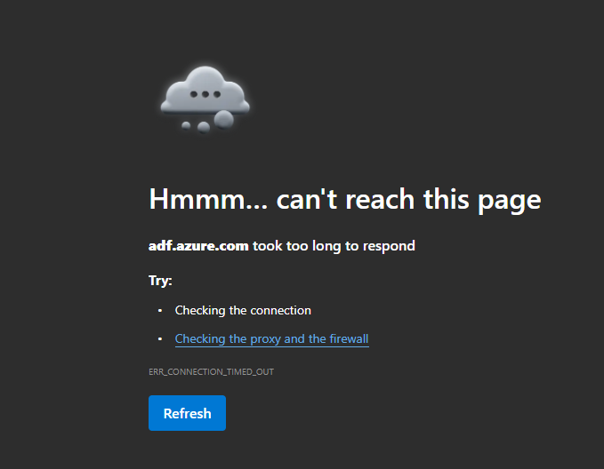

Hi
I can't reach adf.azure.com. Clearing cache and cookies or changing to a different browser (Firefox, Chrome, Edge) on the same laptop doesn't work. I can still open the browser on my phone and access just fine. What am I missing?

Since the issue happens on the laptop across Firefox, Chrome, and Edge, but works on the phone, this points to a laptop-side network, DNS, proxy, firewall, or cookie setting issue rather than an Azure Data Factory service outage.

Given the screenshot shows ERR_CONNECTION_TIMED_OUT, the strongest next checks are:
  • third-party cookie settings for adf.azure.com
  • VPN/proxy/firewall on the laptop
  • DNS resolution from the laptop with nslookup

    Since the issue occurs on multiple browsers on the same laptop, while ADF works on the phone, we recommend checking the laptop network, VPN, proxy, DNS, or firewall.
    Please test ADF using a mobile hotspot. If it works, the issue is most likely with the corporate network or VPN. Also, verify that the required Azure endpoints are allowed through the corporate proxy/firewall.
