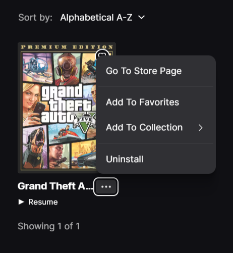

I am having trouble installing GTA V.
Some time ago, I had a secondary Kingston SSD (H:) on my computer. I tried to install GTA V on it once, but it ran out of space and threw an error, so I canceled the installation.
Recently, I upgraded my computer with a new secondary SSD, a SanDisk (G:). Then I took the Kingston to upgrade another computer of mine, and already formatted and installed an OS. In other words, no recovery from the GTAV's half-instalation files.
Now, the GTAV appears on my Epic Games library as incomplete download, asking to either resume the download, or, letting me uninstall it:

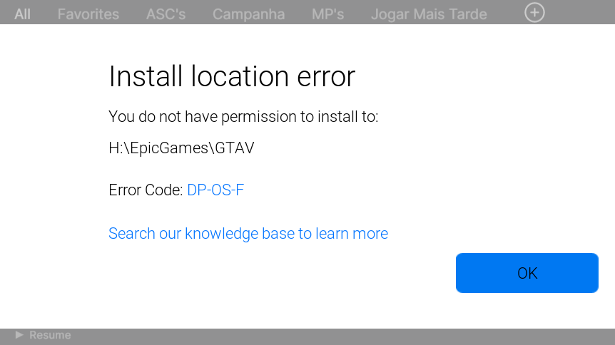

When I try to resume, I get this error screen:
Error Code: DP-OS-F

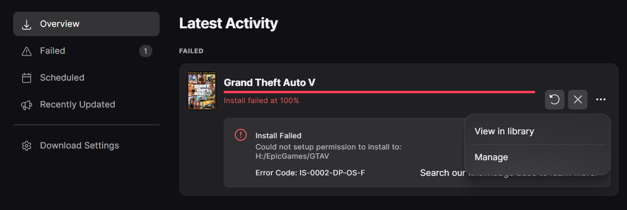

If I try to uninstall, it opens this screen:
Error Code: IS-0002-DP-OS-F
I have the options to Restart🔄️, Cancel❎ and Options [...] (which includes 'Manage').
Clicking Restart🔄️ throws the exact same error screen shown above.

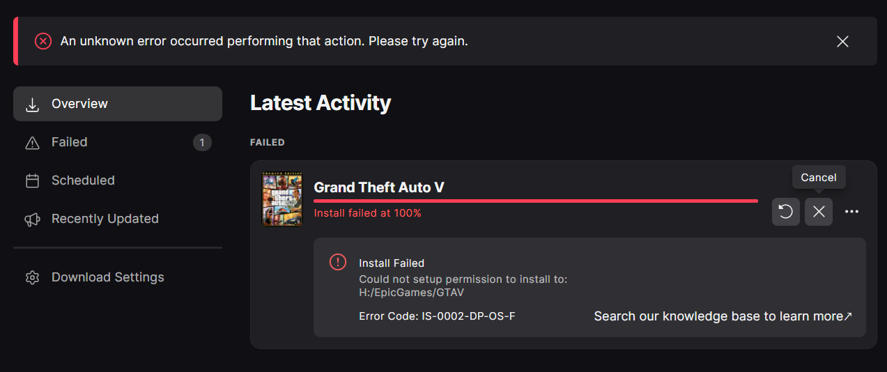

Clicking Cancel❎ gives me this error message:

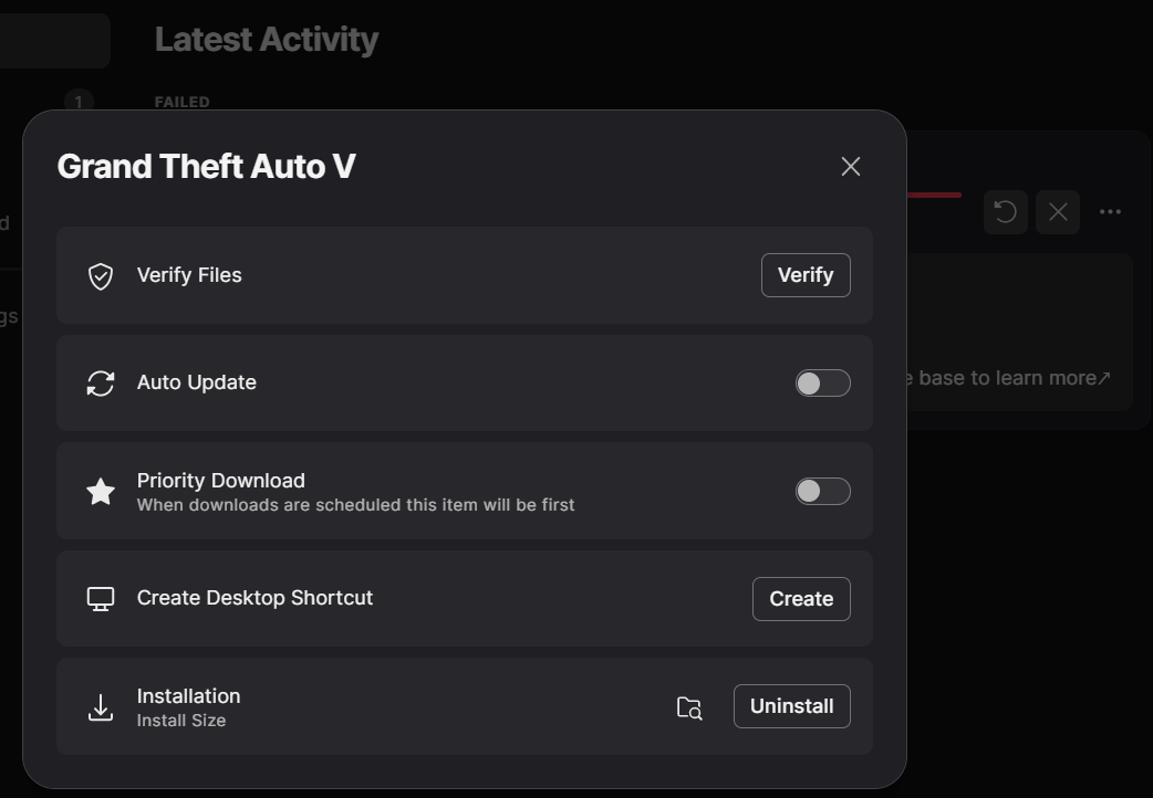

Clicking Manage takes me to this screen:
If I click Verify Files, the window just closes. Clicking Uninstall attempts to really uninstall, but fails and returns to the "Install failed at 100%" red text.
The📁🔍 (Open Install Location) button does absolutely nothing.

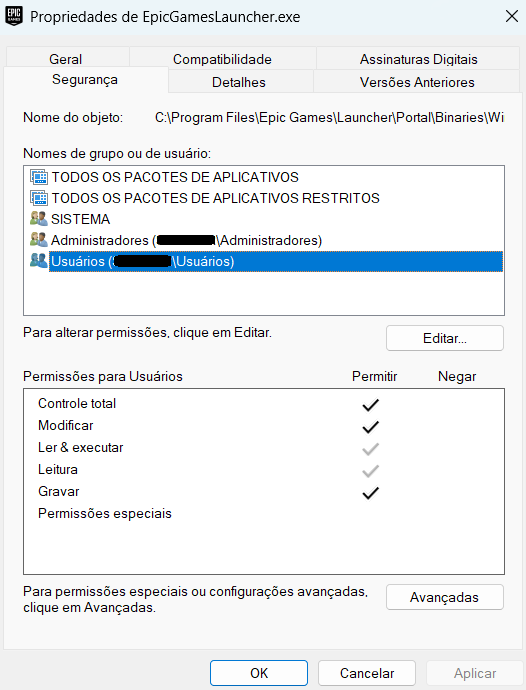

  4. Granting "Full Control" in the Security tab of EpicLauncher.exe properties (my system language is PT-BR): img6

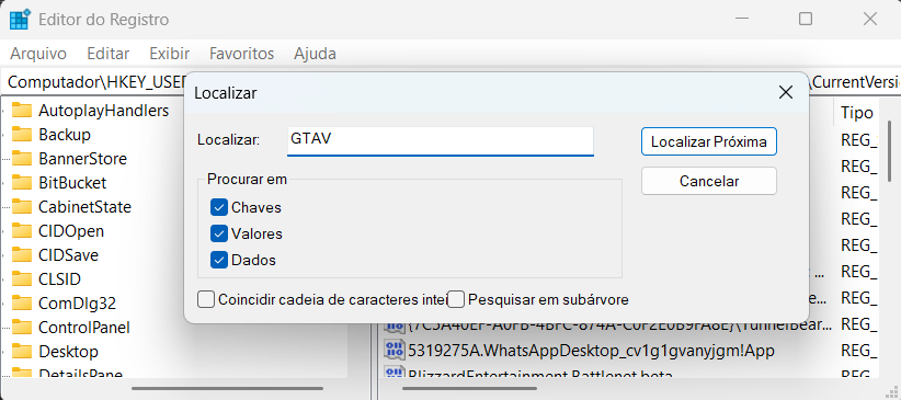

  6. Opening regedit (Win + R) and deleting absolutely all keys, registries, and folders where "GTAV" or "GTA5" appear. None of this worked. This makes me think Epic Games is recovering a failed installation state from the cloud every time I reinstall the launcher and log in. img7

  1. Vitor Hugo Leite 0 Reputation points
    2026-08-14T02:14:01.2833333+00:00
    [SOLVED] [NOT OFFICIAL] [RISKY] [REQUIRES SHARING SENSITIVE INFO]
    Finally, after all these attempts, I managed to solve this issue. However, it involves sharing your Epic Games credentials with someone you fully trust and approving their login (if you have Two-Factor Authentication enabled).
    Based on the theory I mentioned earlier—that Epic Games saves the state of a corrupted installation in the cloud—we need to force a reset of that state. I was able to do this using the following steps (assuming Epic Games is installed on your (C:) drive):
    Uninstall the Epic Games Launcher.
    1. Delete any Epic Games-related folders located in these paths:
    C:\ProgramData
    C:\Users\[MyUser]\AppData\Local
    C:\Users\[MyUser]\AppData\Local\Temp
    C:\Users\[MyUser]\AppData\LocalLow
    C:\Users\[MyUser]\AppData\Roaming
    Run a search for "Epic Games" in the root directory of your (C:) drive and delete any remaining files or folders.
    Ask a trusted friend who already has GTA V installed (via Epic Games) on their own PC to log out of their account and log into yours.
    Reinstall the Epic Games Launcher on your PC and check the status of GTA V. After step 5, the game finally allowed me to install it properly. If this doesn't work for you right away, I suggest logging out on your PC and asking your friend to start the uninstallation of GTA V on their PC while logged into your account. This might force Epic Games to update the installation status in the cloud.
