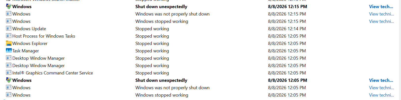

For some time, my computer has randomly experienced BSODs at the rate of one every few days. In the Reliability Monitor, these were often coupled with failures in Windows utilities like Antimalware Service Executable.
I reinstalled Windows 11 to see if that would fix it, but am still seeing the issue. They seem to happen randomly, but I can fairly reliably trigger a BSOD by installing new software or running commands like DISM.
Here's some BSODs from me running DISM commands, a week after reinstalling the machine:

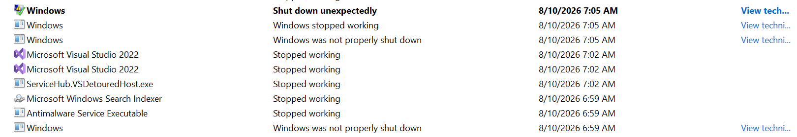

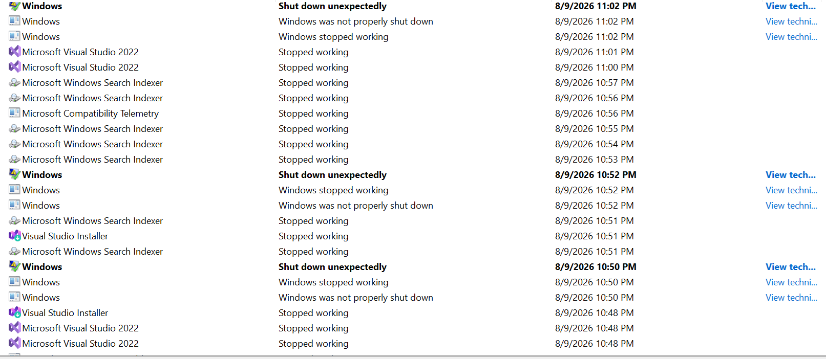

And here are some BSODs from trying to install Visual Studio:
I'm trying to figure out if there's anything I can do to stop these from happening, or use the information from the crash reports to track down the issue/offending part if it's a hardware issue.

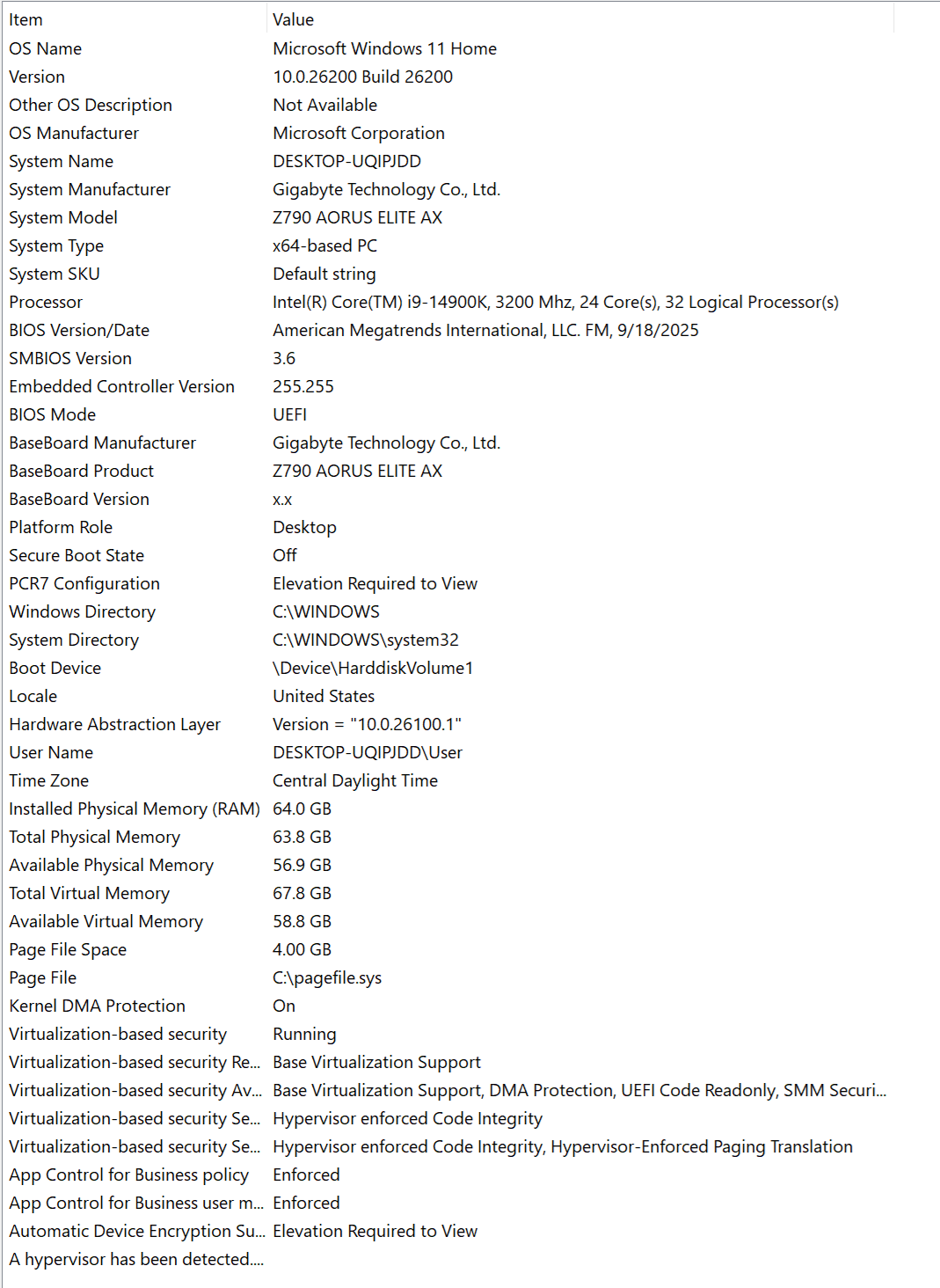

Search for msinfo32.exe in the search bar, take a screenshot, and post it here so we can see the correct laptop model or desktop configuration.

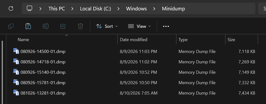

Access the c:\windows\minidump folder, copy the files to your desktop, then upload them to OneDrive or Google Drive and post the link here for analysis.

    The computer has rebooted from a bugcheck.  The bugcheck was: 0x00000050 (0xfffff80693e06330, 0x0000000000000003, 0xfffff8062578e8d9, 0x0000000000000002). A dump was saved in: C:\WINDOWS\Minidump\081026-13281-01.dmp. Report Id: cfc355b0-1cf2-49ee-94d6-4b1d82ec3290.
