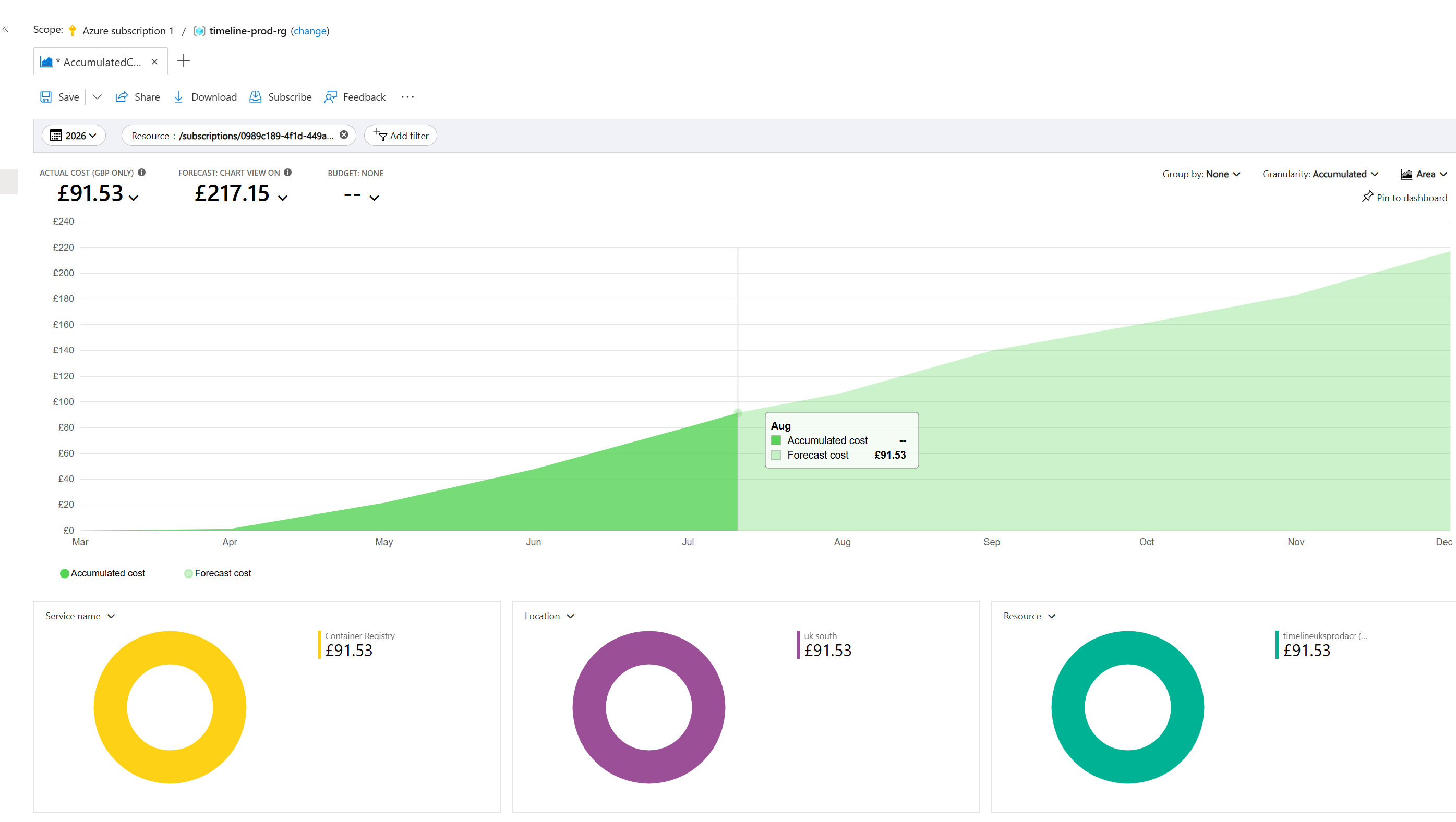

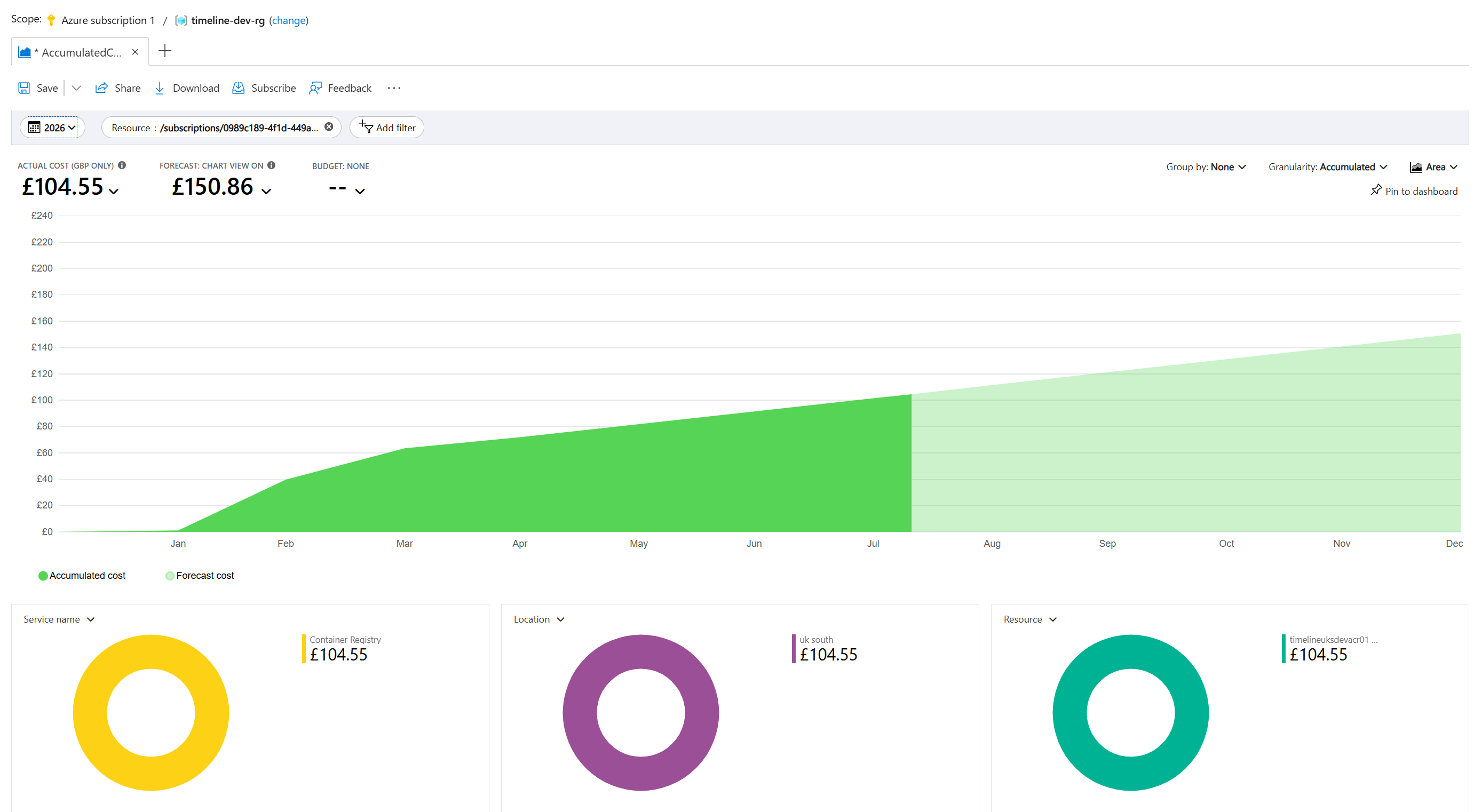

We are seeing a substantial and apparently stale Azure Container Registry
storage usage/accounting discrepancy in UK South.

- timelineuksdevacr01 Resource group: timeline-dev-rg SKU: Basic Reported StorageUsed/show-usage: 98,566,384,671 bytes (91.80 GiB)
- timelineuksprodacr Resource group: timeline-prod-rg SKU: Standard Reported StorageUsed/show-usage: 441,983,717,571 bytes (411.63 GiB)

Despite successful manifest deletion, az acr show-usage and the Azure
Monitor StorageUsed metric remain unchanged at 91.80 GiB and 411.63 GiB.

The dev registry is particularly concerning because its reported usage
has remained at approximately 91.8 GiB for an extended period, rather
than this only being a short delay following today's purge.
Please:
- Inspect the backend ACR storage accounting and garbage-collection state for orphaned/unreferenced blobs.
- Confirm the current billable storage quantity for each registry, independently of the delayed StorageUsed metric.
- Confirm whether additional-storage charges stopped when the manifests were deleted.
- Force or repair garbage collection/storage accounting if it is stuck.
- Explain the difference between reachable manifest/layer data and the reported StorageUsed values.
- Review and credit any additional-storage charges caused by incorrectly retained or incorrectly billed deleted image data.
Microsoft documentation states that billing for deleted image data stops
immediately, although physical reclamation and the StorageUsed metric are
asynchronous. Please confirm that this is occurring for these resources.
