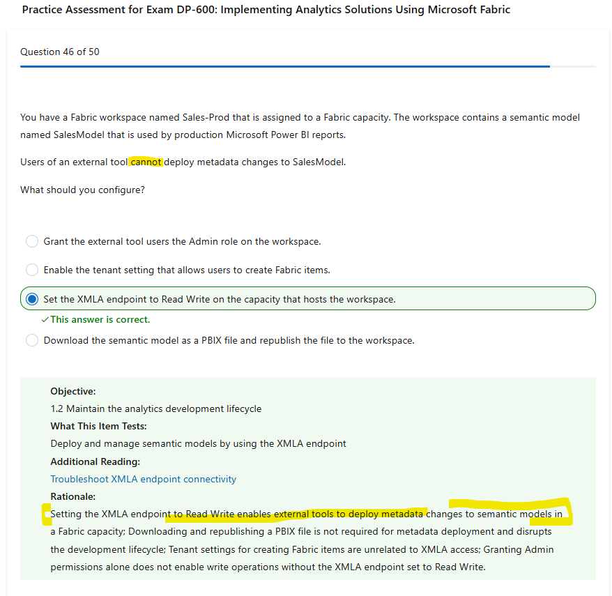

Incorrect Question on DP600 exam
Sasmit Sharma 25 Reputation points
2026-08-09T07:45:00.2266667+00:00
the Question says Cannot modify the metadata but the answer and clarification says it can and still the answer was right, it was mis leading with the word Cannot as highlighted

Yep - the wording is misleading. The statement that external-tool users “cannot deploy metadata changes” sounds like the users are fundamentally unable to modify the semantic model, which would suggest that permissions or some other access setting is missing.
What the question actually means is that the external tool cannot currently deploy metadata changes because the XMLA endpoint is not configured for write operations. Once the capacity's XMLA endpoint is set to Read Write, the external tool can deploy those metadata changes.
So the intended interpretation is: “Users of an external tool cannot deploy metadata changes to SalesModel [because the XMLA endpoint is currently read-only]. What should you configure?” The answer is correct, but the wording of “cannot” is unnecessarily ambiguous and can easily lead you toward the workspace-permission answers.
Microsoft staff monitors this forum, so hopefully at some point this will be corrected. Also note that, in general, questions on the actual exam are subject to more scrutiny that practice questions.
