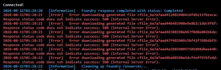

i am getting below error on requesting agent while simple questions work but when my prompt requires code_interpreter support then it gives error like below on commandline
openai.InternalServerError: Error code: 500 - {'error': {'message': 'The server had an error processing your request. Sorry about that! You can retry your request, or contact us through an Azure support request at: https://go.microsoft.com/fwlink/?linkid=2213926 if you keep seeing this error. (Please include the request ID 55d68e2e-e807-49f5-80be-55f1ce3be60d in your email.)', 'type': 'server_error', 'param': None, 'code': None}}

    There is precedent for exactly this issue
    Microsoft Q&A has reports of Azure AI Foundry returning server_error specifically when code_interpreter generates graphs. One report describes calculations working while graph generation fails, including cases where an image ID is produced but the corresponding file isn't available.
    So I would not immediately rewrite your agent code based only on this 500.
    Also check your model/deployment
    Microsoft recommends checking the current regional and model availability for Code Interpreter because support varies by model/region.https://learn.microsoft.com/th-th/azure/foundry/agents/how-to/tools/code-interpreter?view=foundry&utm_source=chatgpt.com&pivots=python
    If you're using something like gpt-4.1-mini, there's an especially interesting precedent: a Microsoft Q&A report found that Code Interpreter calculations worked but graph generation failed, while gpt-4.1 worked.https://learn.microsoft.com/en-us/answers/questions/5641829/server-error-occurs-in-azure-ai-foundry-when-gener?utm_source=chatgpt.com

    If the request dies with HTTP 500 before you get a normal tool result, that is useful evidence that the failure is occurring on the Azure/Foundry service side rather than being a Python exception in your application.
    One important distinction
    If your error is literally:
        'error': {
            'message': 'The server had an error processing your request...',
    then this is not the same as Python code inside Code Interpreter throwing an exception.
    A Python exception would normally be returned as part of the agent/tool execution, allowing the agent to potentially retry or correct the code. Code Interpreter is specifically designed to iteratively modify and rerun failed Python code.https://learn.microsoft.com/en-us/azure/foundry-classic/agents/how-to/tools-classic/code-interpreter?view=foundry-classic&utm_source=chatgpt.com&pivots=python
    Your error is occurring at the API request level.
