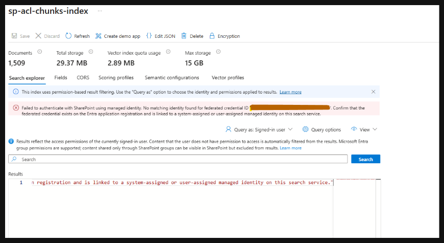

I'm using the preview SharePoint site-group enforcement at query time - sharePointConnectorAppRegistration on the index plus x-ms-query-source-authorization on the query, API version 2026-05-01-preview. Whenever a query actually triggers SharePoint group resolution, I get:
HTTP 400 Failed to authenticate with SharePoint using managed identity.No matching identity found for federated credential ID '<fic-id>'.Confirm that the federated credential exists on the Entra application registration and is linked to a system-assigned or user-assigned managed identity on this search service.
The frustrating part is that the indexer authenticates to SharePoint through the exact same managed identity → connector app federation and runs to success — it pulls content and the spg: ACLs without any issue. So the trust itself clearly works. It only breaks on the query-time path.
The <fic-id> in the error is exactly the FIC referenced by the index's sharePointConnectorAppRegistration.

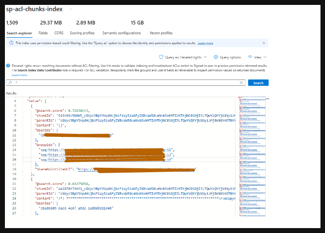

  • ACLs are correctly ingested onto every chunk. An elevated-read query (x-ms-enable-elevated-read: true) returns documents where each chunk has spg:-prefixed values in GroupIds (e.g. spg:https://<tenant>.sharepoint.com/sites/<site>:52), a populated SharePointSiteUrl, and UserIds. So the data and index projections are right.
  • The permission filter works. A query with no query-source header returns HTTP 200 with zero results (everything trimmed, as expected with no identity supplied); elevated read returns the documents. So trimming is active and correct.
What fails: only the query-time SharePoint site-group resolution. The moment a valid same-tenant end-user token (audience https://search.azure.com) is passed via x-ms-query-source-authorization, I get the 400 above. The message is the search service authenticating to SharePoint via the MI/FIC — before the caller's membership is evaluated — so it's not user-specific and reproduces with any valid same-tenant token.

Is this a known defect in the 2026-05-01-preview query-time SharePoint site-group resolution path or is there an additional binding required specifically for the query-time path — beyond the FullControl site grant and the managed-identity → connector-app federation that ingestion already uses successfully?issue1
