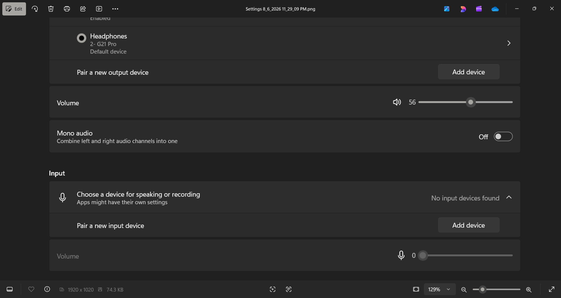

Settings 8_6_2026 11_29_09 PM.png 8_7_2026 5_40_30 AM
my audio output works perfectly fine but no matter what the laptops input mic will not work. i have tested it on other apps and sites and even tried with a headset or earbuds that worked before this issue but yet still no audio input.

Go to Start menu > Settings > System > Sound > Scroll down to More sound settings > Recording tab > Right-click on the white area, check the option "Show disconnected devices" and "Disabled" and see if the microphone driver is enabled and enable it.
If that doesn't work:
Are you referring to the laptop's internal microphone?
In that case, search for msinfo32.exe in the search bar, take a screenshot, and post it here so we can see the correct laptop model or desktop configuration.
Access Device Manager > Sound, video and game controllers, take a screenshot and post it here.
