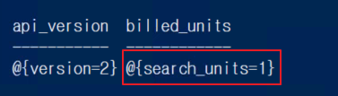

I am currently using the Cohere-rerank-v4.0-fast model deployed in Microsoft Foundry, and I would like to clarify how billing is calculated for this model.
According to the official documentation, Cohere Rerank models are billed based on a search unit. Does this "search" unit correspond to the billed_units.search_units value returned in the Cohere API response?
In other words, is the billing amount calculated based on the search_units value shown in the attached screenshot?
I would appreciate an official clarification on whether billed_units.search_units is the exact usage value used for Microsoft Foundry billing.

Yes, your understanding is correct. The billed_units.search_units value returned in the Cohere Rerank API response is the exact meter that Microsoft Foundry uses for billing, since Foundry passes through Cohere's own usage metering for pay-as-you-go serverless deployments rather than calculating a separate internal count.
Understand what one search unit represents According to Microsoft's own documentation for deploying Cohere Rerank models, a single search unit corresponds to one query evaluated against up to 100 documents. Documents that exceed 500 tokens (including the query length) are split into multiple chunks, and each chunk counts as a separate document toward that 100-document limit. If a single call needs more than 100 documents worth of chunks to be ranked, it consumes multiple search units.
Map this to the API response field The billed_units.search_units field in the Cohere API response reports exactly this count for that specific call, so it is the authoritative usage number for that request. There is no separate token-based or character-based calculation layered on top by Azure for the Rerank models specifically, unlike Cohere's Command or Embed models which bill on tokens.
Verify against your own usage in the portal To confirm this matches what you're actually billed, go to Cost Management + Billing → Cost analysis in the Azure portal, filter by the resource group or resource containing your Cohere-rerank-v4.0-fast deployment, and group by Meter. The consumed quantity shown there for the Rerank meter should track the cumulative search_units values you're seeing returned across your API calls over the same billing period.
If the numbers don't reconcile If you tally up search_units from your calls and it doesn't match the quantity shown in Cost analysis for the same period, that points to a metering discrepancy rather than a misunderstanding of the pricing model, and it's worth opening a support request under Technical with problem type Foundry Models / Cohere so the billing telemetry can be checked against your deployment logs.
