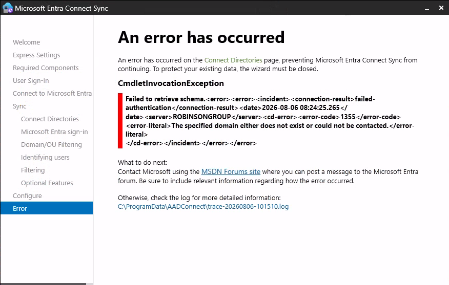

I understand that using a single-label domain isn't supported by the Entra ID sync connector, but I can't consider migrating to another domain at this time. Please, is there a way to make it work?
This is the error displayed:
Thank you

    Yes, but only in a limited sense.
    A single-label domain is supported by Microsoft Entra Connect Sync only if the network configuration for that single-label domain is functioning correctly. However, Microsoft strongly recommends against single-label domains.
    There is one important unsupported case: if the Active Directory NetBIOS domain name differs from the FQDN domain name, installing Microsoft Entra Connect is unsupported.
    For sign-in to Microsoft Entra ID, the larger constraint is that Microsoft Entra Connect can sync only to a verified domain in Microsoft Entra ID. Single-label and other nonroutable domains can't be verified in Microsoft Entra ID. In that situation, the supported path is to use custom settings in Microsoft Entra Connect and configure a routable, verified sign-in domain instead of relying on the single-label domain suffix.
    If the on-premises UPN suffix is nonroutable, the documented options are:
    1. Add a new UPN suffix in AD DS that matches a domain verified in Microsoft Entra ID.
    2. Update user UPNs to use that verified suffix.
    3. Run Microsoft Entra Connect using custom installation so the sign-in configuration uses the verified domain.
    If changing every user UPN is not possible immediately, Microsoft Entra Connect custom installation also supports selecting another attribute as the sign-in ID when userPrincipalName is nonroutable. This is the alternate ID option. That attribute must follow RFC 822 format, and in Active Directory it can't be multivalued.
    So the practical answer is:
    • Keeping the single-label AD domain itself may be possible if the environment is otherwise valid.
    • Using that single-label name as the Microsoft Entra sign-in domain is not supported, because Microsoft Entra ID requires a verified routable domain.
    • The supported workaround is to keep the existing AD domain, but add and use a verified routable UPN suffix or configure an alternate ID during custom setup.
