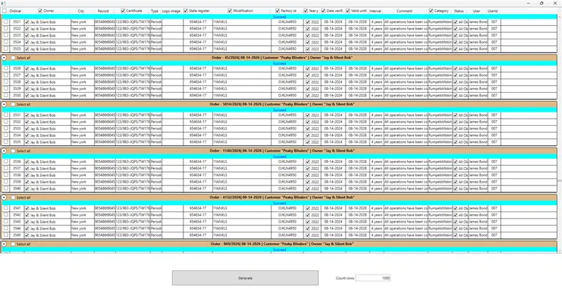

Hello.
How fix this?
<UserControl.Resources>
    <CollectionViewSource x:Key="CollectionViewBusinesDataGrid" Source="{Binding BusinesDataGridItemsSource, IsAsync=True}">
        <CollectionViewSource.GroupDescriptions>
            <PropertyGroupDescription PropertyName="OrderDataView" />
            <PropertyGroupDescription PropertyName="WorkStatusView"/>
        </CollectionViewSource.GroupDescriptions>
        <CollectionViewSource.SortDescriptions>
            <componentModel:SortDescription PropertyName="Ordinal" Direction="Ascending"/>
            <componentModel:SortDescription PropertyName="WorkStatus" Direction="Ascending"/>
        </CollectionViewSource.SortDescriptions>
    </CollectionViewSource>
</UserControl.Resources>
<DataGrid Grid.Row="2" x:Name="BusinesDataGrid" ColumnHeaderStyle="{DynamicResource DGridCentAl}" ItemsSource="{Binding Source={StaticResource CollectionViewBusinesDataGrid}, IsAsync=True}" SelectedIndex="{Binding BusinesDataGridSelectedIndex}" IsEnabled="{Binding Enabled}" EnableColumnVirtualization="True" EnableRowVirtualization="True" VirtualizingPanel.IsVirtualizing="True" VirtualizingPanel.IsVirtualizingWhenGrouping="True" VirtualizingPanel.VirtualizationMode="Recycling" VirtualizingPanel.ScrollUnit="Pixel" SelectionMode="Single" CanUserSortColumns="False" CanUserResizeColumns="False" CanUserResizeRows="False" CanUserReorderColumns="False" AutoGenerateColumns="False" IsReadOnly="False" Width="Auto" Height="Auto" HeadersVisibility="Column" CanUserAddRows="False" VerticalScrollBarVisibility="Auto" HorizontalScrollBarVisibility="Auto">
</DataGrid >

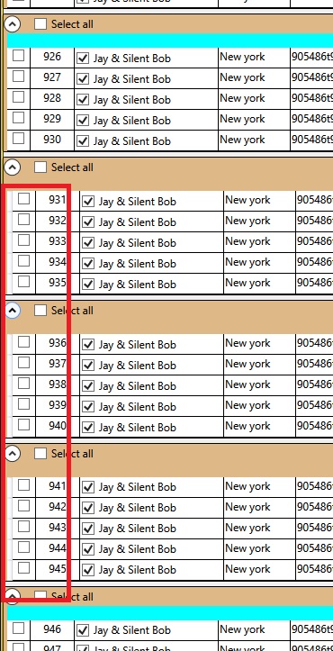

Hello @Sergey Dorodnov ,
Thank you for providing the additional source code.
I recreated a test project using the relevant DataGrid configuration from the code you shared, including:
  • A CollectionViewSource with two group descriptions.
  • Sorting by Ordinal and WorkStatus.
  • IsAsync=True in the supplied bindings.
  • Row and column virtualization.
  • IsVirtualizingWhenGrouping=True.
  • VirtualizationMode="Recycling".
  • ScrollUnit="Pixel".
  • A DataGridCheckBoxColumn.
  • Multiple DataGridTemplateColumn elements.
  • More than 100 rows.
Test result
I tested vertical and horizontal scrolling with grouping enabled, including scrolling to positions where the first row was only partially visible. However, I was unable to reproduce the horizontal displacement shown in your screenshot, where the cells and borders of the first visible row appear shifted slightly to the right.
My test reproduced the virtualization, grouping, sorting, and column types from the supplied code, but it did not include every style, template, converter, event handler, and bound component from the complete application. Therefore, the result indicates that the basic combination of grouping and Recycling virtualization is not sufficient by itself to reproduce the problem.
I also tested:
VirtualizingPanel.VirtualizationMode="Standard"
I agree that Standard mode can make scrolling noticeably slower.
Difference between Standard and Recycling
With Standard virtualization, WPF creates a container when an item enters the viewport and discards that container when the item leaves.
With Recycling virtualization, WPF reuses existing DataGridRow and DataGridCell containers for different data items. This generally improves scrolling performance because fewer controls, templates, and bindings need to be recreated.
This does not prove that Recycling itself is defective. However, it means that a style, trigger, event handler, or template that changes container state must also restore that state correctly when the container is reused.
Microsoft documentation:
VirtualizationMode Enum Optimize control performance in WPF
Remove the mouse-over editing trigger
The first test I recommend is temporarily removing this trigger:
<Trigger Property="IsMouseOver" Value="True">
    <Setter Property="IsEditing" Value="True" />
</Trigger>
Then test again with the original virtualization settings:
<DataGrid
    ScrollViewer.CanContentScroll="True" />
Setting IsEditing from an IsMouseOver trigger causes the cell to switch between its display and editing templates during mouse movement. With Recycling enabled, the same cell container can later represent another item.
This is currently a hypothesis because I could not reproduce the displacement in the test project. However, the trigger directly affects cell state and template layout, so it should be isolated first.

Use Item scrolling with Recycling
Before using Standard mode permanently, keep Recycling enabled and change only the scrolling unit:
<DataGrid
    VirtualizingPanel.ScrollUnit="Item"
Pixel scrolling allows the viewport to stop between row boundaries, so the first visible row can be only partially displayed. Item scrolling moves the viewport by complete items.

If the displacement disappears, restore the original group template incrementally and check nested panels, expanders, margins, transforms, and width bindings.
Because IsVirtualizingWhenGrouping=True is enabled, group containers and item containers both participate in the scrolling layout. A custom grouping template should therefore be tested independently from the column templates.

Based on the reported symptom, I suggest trying the workarounds in this order:
  1. Remove the IsMouseOver : IsEditing trigger.
  2. Keep Recycling but use ScrollUnit="Item".
  3. Keep row recycling but disable column virtualization.
  4. Identify and simplify the specific template or style causing the problem.
  5. Use Standard virtualization with deferred scrolling only if the earlier options do not resolve it.
However, based on the XAML you shared, I also noticed that the DataGrid contains a large number of DataGridTemplateColumn, CheckBox controls, custom header templates, event handlers, and grouping templates. Since these elements interact closely with WPF's container recycling mechanism, the root cause may be related to a specific template or layout behavior rather than DataGrid virtualization itself. Further isolation testing by temporarily simplifying some templates may help identify which component is triggering the misalignment.
