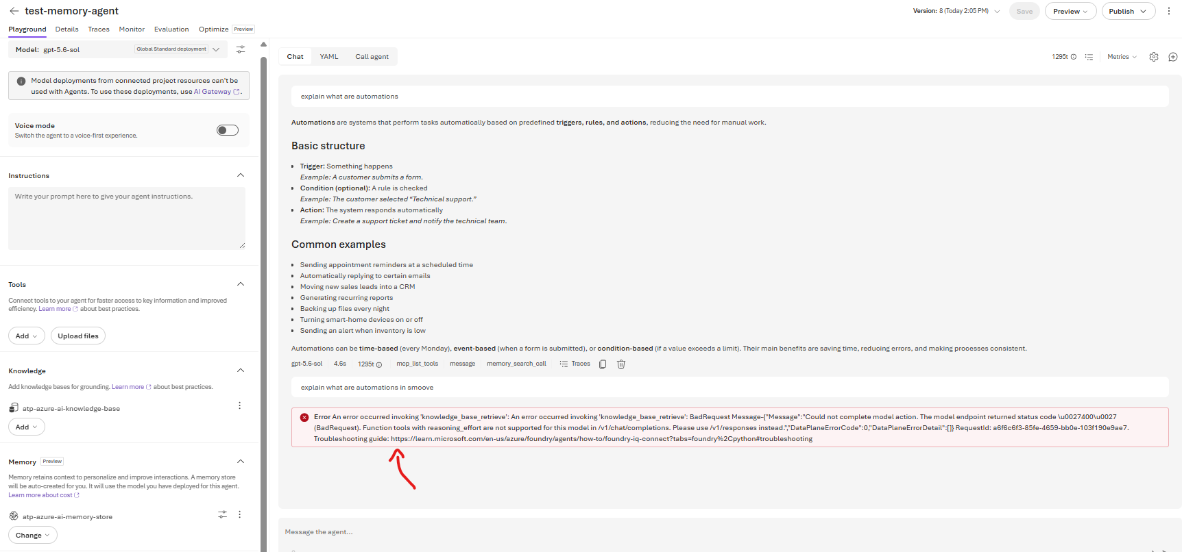

Azure Foundry agents seem to be using the old Completions API by default.
Is it possible to configure it to use the newer Responses API?
Here's a test i did:

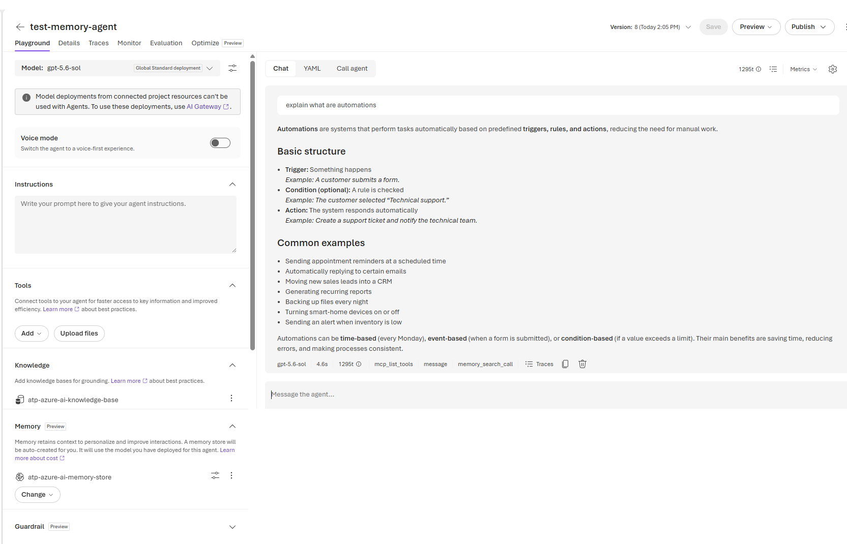

First turn - No KB usage:
I set up an agent with a connected Knowledge Base and a connected Memory. However, For this test purposes, I intentionally ask a general question which doesn't require a KB query.
Result: success - as can be seen in the below screenshot:
First turn - No KB usage - Success
Second turn - With KB usage:
With the same agent, in a subsequent turn, I ask a question whose answer requires a KB query.
This is indeed what happens, and issues an error:
Error: An error occurred invoking knowledge_base_retrieve: An error occurred invoking knowledge_base_retrieve: BadRequest Message-{"Message":"Could not complete model action. The model endpoint returned status code \u0027400\u0027 (BadRequest). Function tools with reasoning_effort are not supported for this model in /v1/chat/completions. Please use /v1/responses instead.","DataPlaneErrorCode":0,"DataPlaneErrorDetail":[]} RequestId: a6f6c6f3-85fe-4659-bb0e-103f190e9ae7. Troubleshooting guide: https://learn.microsoft.com/en-us/azure/foundry/agents/how-to/foundry-iq-connect?tabs=foundry%2Cpython#troubleshooting
Result: failure - as can be seen in the below screenshot: Second turn - With KB usage - Failure
The error indicates the agent is using the older /v1/chat/completions api, instead of the newer /v1/responses.
Searching the web, this issue started since GPT 5.4, so I tried using GPT 5.2 and that indeed works - but I want to be able to use the latest models.Is this something I could configure to fix it?

Currently, there is no option to configure Azure AI Foundry Agents to use the /v1/responses API. The managed Agent Service handles the underlying API calls and currently uses /v1/chat/completions for tool invocations such as Knowledge Base retrieval.
This is why your first prompt succeeds (no tool call), while the second fails when the KB tool is invoked with newer reasoning models like GPT-5.4 and GPT-5.6.
As a workaround, you can either use GPT-5.2/GPT-4o, or call the Responses API directly and manage the orchestration yourself.
