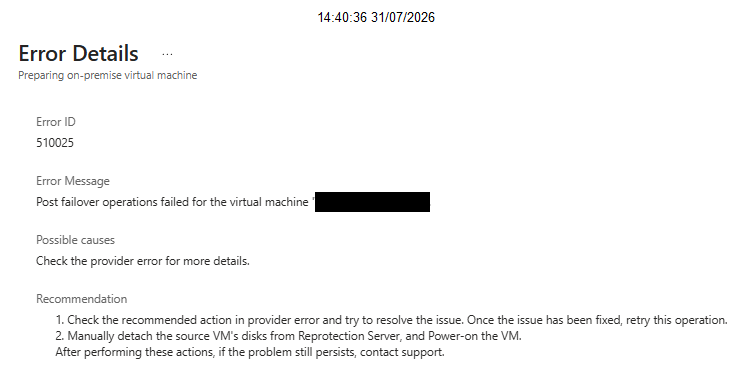

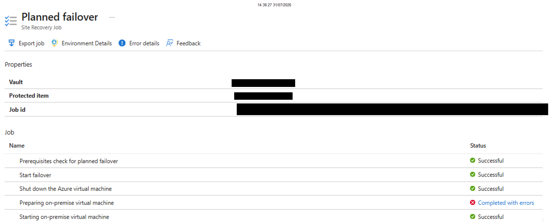

I am using Azure Site Recovery to replicate on premise VMs to Azure. The replication works fine but when I perform a failover and fail back I get an error when failing back and I can not find any details on the error and what I need to do.
When failing back from Azure to on premise I receive the error below when I select to do a "Planned Failover".
Error details:
I don't know where to start to troubleshoot this, I cant find the error code anywhere, and cant find any more logs details.
The on premise VM looks fine, I can log into it and can't see any issues, its disk all look fine.
If I just ignore the error and "Commit" the failback it succeeds and I can then successfully reprotect the VM. So everything looks absolutely fine except for this error. I would appreciate any suggestion to help me find out what the error is.

    Hi @Chalee Thank you for sharing the additional details. We understand that the planned failover from Azure to your on-premises environment reports a failure, although the on-premises VM becomes available and you are subsequently able to Commit and Reprotect it.
    The successful Commit and Reprotect operations are positive indicators, but they do not confirm which Planned Failover subtask failed or establish that the underlying issue is resolved. The failure may have occurred during VM shutdown, appliance or disk handling, vCenter/datastore operations, on-premises VM startup, application validation, cancellation, or job-status reporting.
    To identify the exact cause, please share the following from the failed job:
    1. Open Recovery Services vault > Site Recovery jobs.
    2. Open the failed Planned Failover job.
    3. Expand the failed task and open Errors.
    4. Copy the Error ID, Error message, Provider error, Possible causes, and Recommendation exactly as displayed.
    5. Share the failed subtask name and confirm whether the deployment uses an Azure Site Recovery replication appliance or a legacy Configuration Server setup.

    This is a recorded azure site recovery (ASR) post-failover cleanup issue, not an actual failback failure. Error 510025 during “Preparing on-premise virtual machine” typically means ASR failed in post-failover tasks (mainly disk detachment/cache/ mobility service sync) on the Process Server or source VM, not the VM itself. Since your failover, commit, and reprotect all succeed, the core replication path is healthy.
    Start with Process Server logs (C:\ProgramData\ASRLogs) and check for disk/mount or agent communication errors during that timestamp; also verify Mobility Service is up-to-date and running on the onprem VM, and that there are no stale disks still registered in the Replication policy (InMage/RcmSvc mappings). This commonly happens when temporary disks or old replication metadata are not cleaned up. Safe fix: update Mobility Agent, restart InMage/ASR services, and run a test failover + cleanup once to reset state. If it persists, manually remove and re-add disk mappings in reprotect step or re-enable replication for that VM.
    I would suggest ignore + commit working confirms it is a non-blocking clean-up defect, not data risk.
