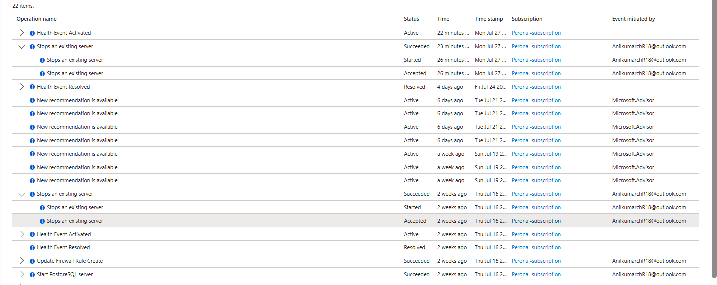

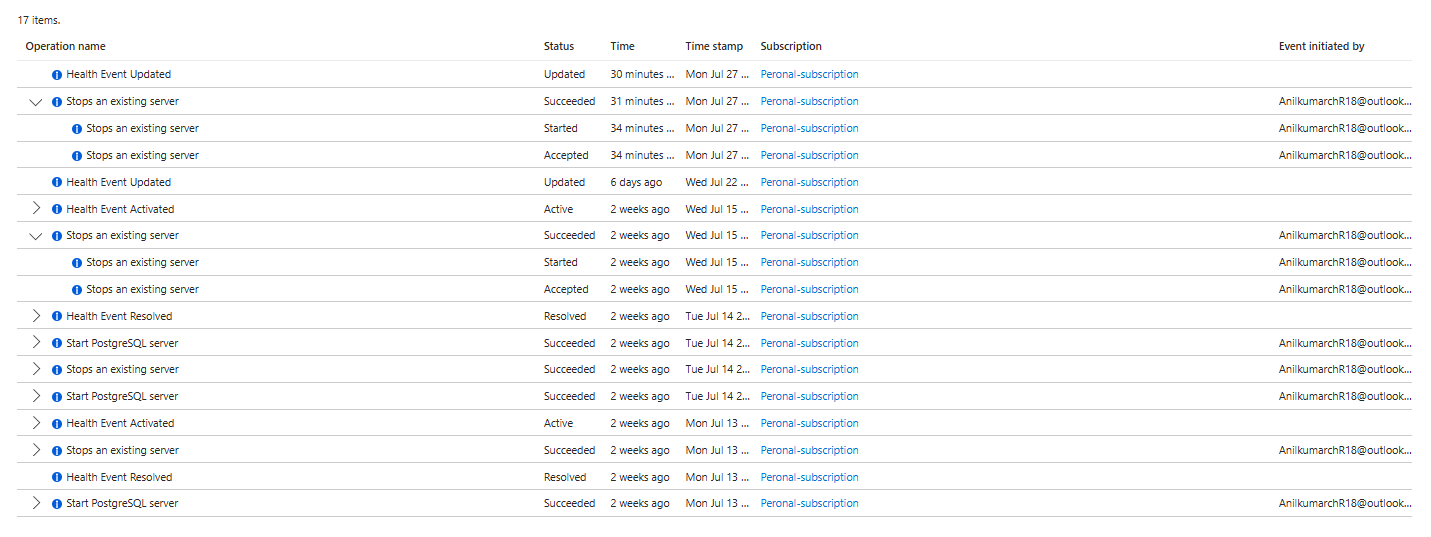

I would like to raise a serious concern regarding unexpected activity in my Azure environment. Two of my databases were automatically turned on without my knowledge, and billing has been initiated for these resources.
Upon reviewing the activity logs, I confirmed that I had previously stopped. However, there is no record indicating that these databases were restarted. For your information, I am the only individual with access to this environment, which makes this situation particularly concerning.

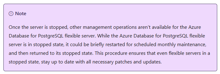

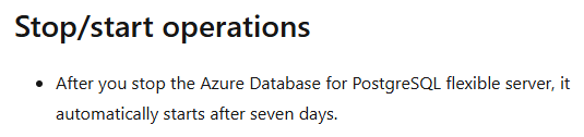

It is normal and expected for Azure Database for PostgreSQL Flexible Server to start automatically 7 days after it was Stopped.
Below is screenshot excerpt from documentation:

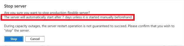

When stopping it via portal, it displays a message letting you know that it will automatically start in 7 days. Please see article below for more details:
Stop compute of a server
https://learn.microsoft.com/en-us/azure/postgresql/configure-maintain/how-to-stop-server
Below is screenshot excerpt from above article, showing portal message after click Stop button:
