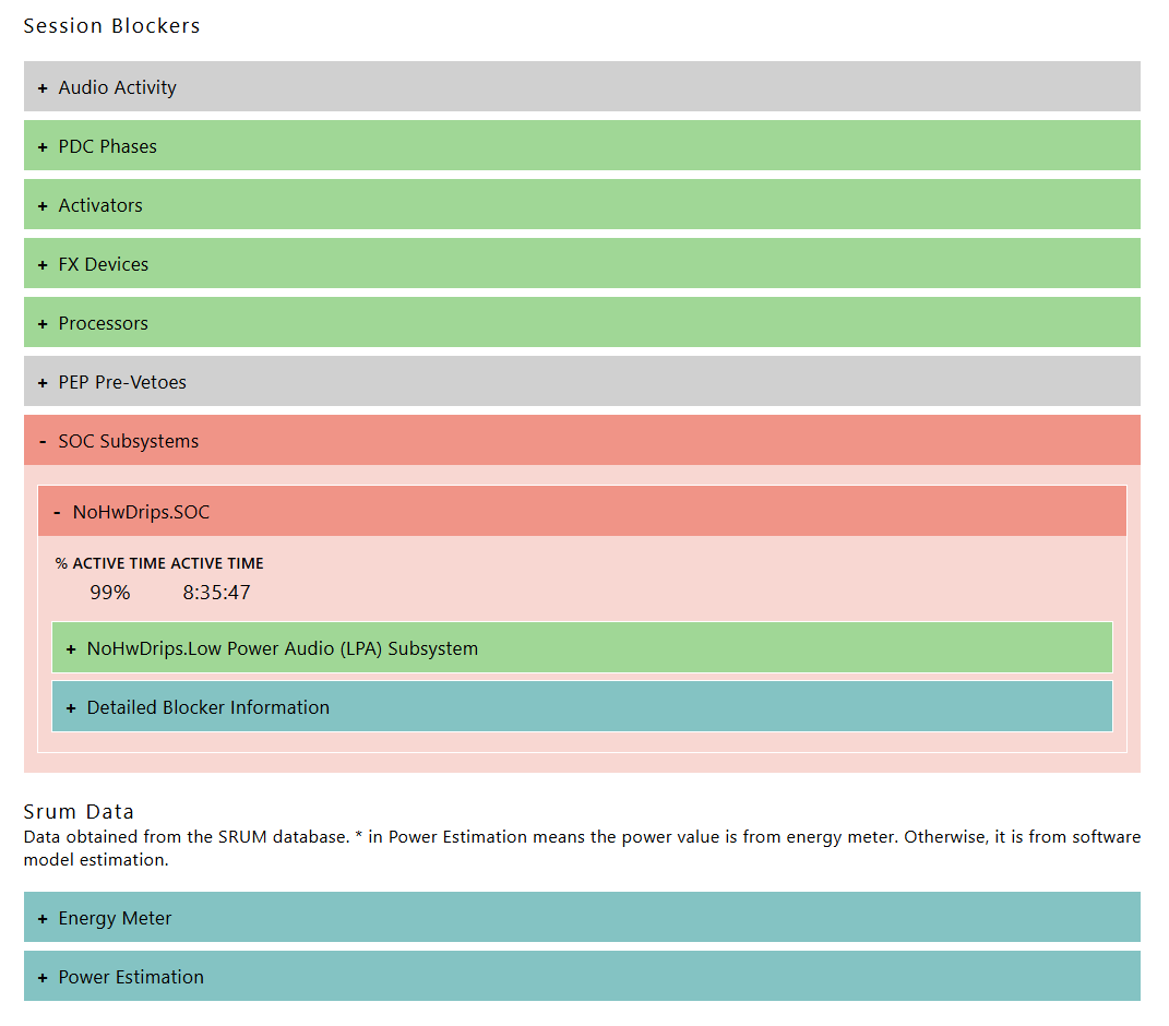

Since June 2026 firmware update for my Surface Laptop 7, I noticed that often times it takes a while to wake up. I know the laptop goes into modern standby (S0) by default, and once the battery drains 5% during modern standby it hibernates.
I ran sleep study (powercfg /sleepstudy) and I see it hasn't gone into Deepest Runtime Idle Platform State (DRIPS) at all during standby:
r/Surface - Surface Laptop 7 (Qualcomm Snapdragon) draining battery quickly in Modern Standby then hibernating
The top offender is Qualcomm Bus Device (_SB.UR15). Any idea what this could be? I'm really seeing nothing useful on the sleep report to see what could be causing this.
r/Surface - FX Devices section
r/Surface - Srum Data section

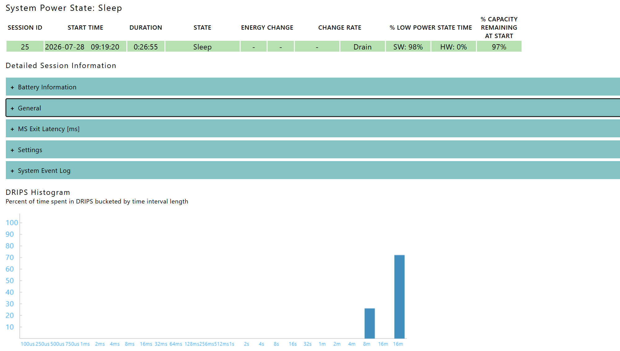

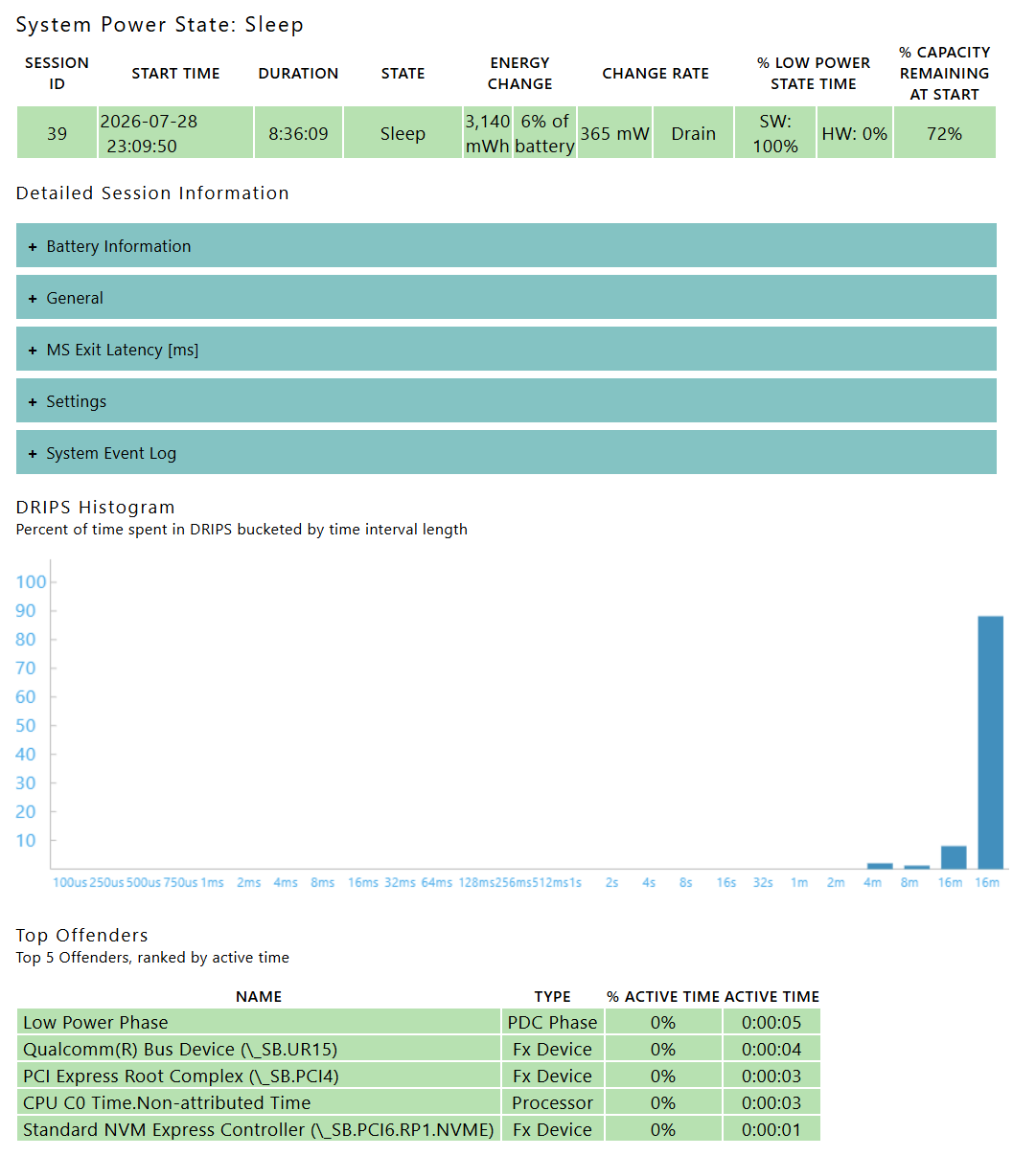

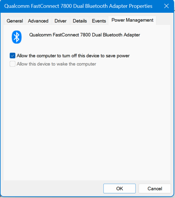

EDIT: I fixed this by going to Device Manager, and enabling the "Allow the computer to turn off this device to save power" option for Qualcomm FastConnect 7800 Dual Bluetooth Adapter.

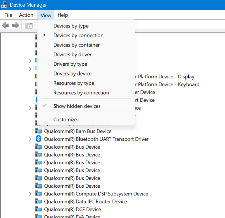

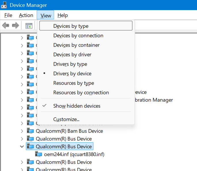

The problem device: _SB.UR15 is a UART bus, not a standalone peripheral — it's almost certainly carrying the Bluetooth radio's UART transport (or possibly GNSS/a sensor). The "Problem Device: TRUE" flag means Microsoft's own tooling has pinned it as what's blocking DRIPS. Airplane Mode/Disconnected Standby didn't help because those control network connectivity, not whether the UART driver is holding a power reference open.
Suggestions:
Device Manager → View → Devices by connection → expand _SB.UR15 to confirm what's actually attached to it.
Test: fully disable Bluetooth in Device Manager, then re-run powercfg /sleepstudy overnight. If UR15 clears up, Bluetooth's UART stack is confirmed as the cause.
