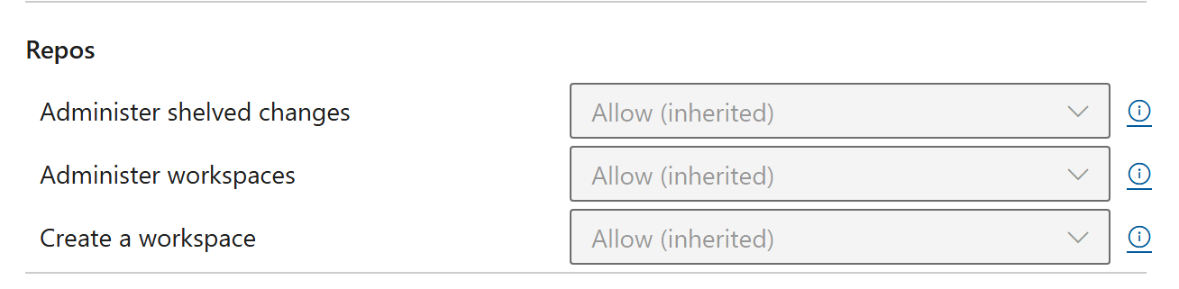

Lee Taylor • 31 Reputation points
2026-07-24T18:53:25.47+00:00 I am the only user, the image shows my privileges in the "Project Collection Administrators" group. I am also the person who set this up 10 years or so ago.

2026-07-24T23:17:54.2966667+00:00 Hi Lee Taylor,
Thanks for the update. Since you're the only user and have Project Collection Administrator permissions, this is unlikely to be a permissions issue.

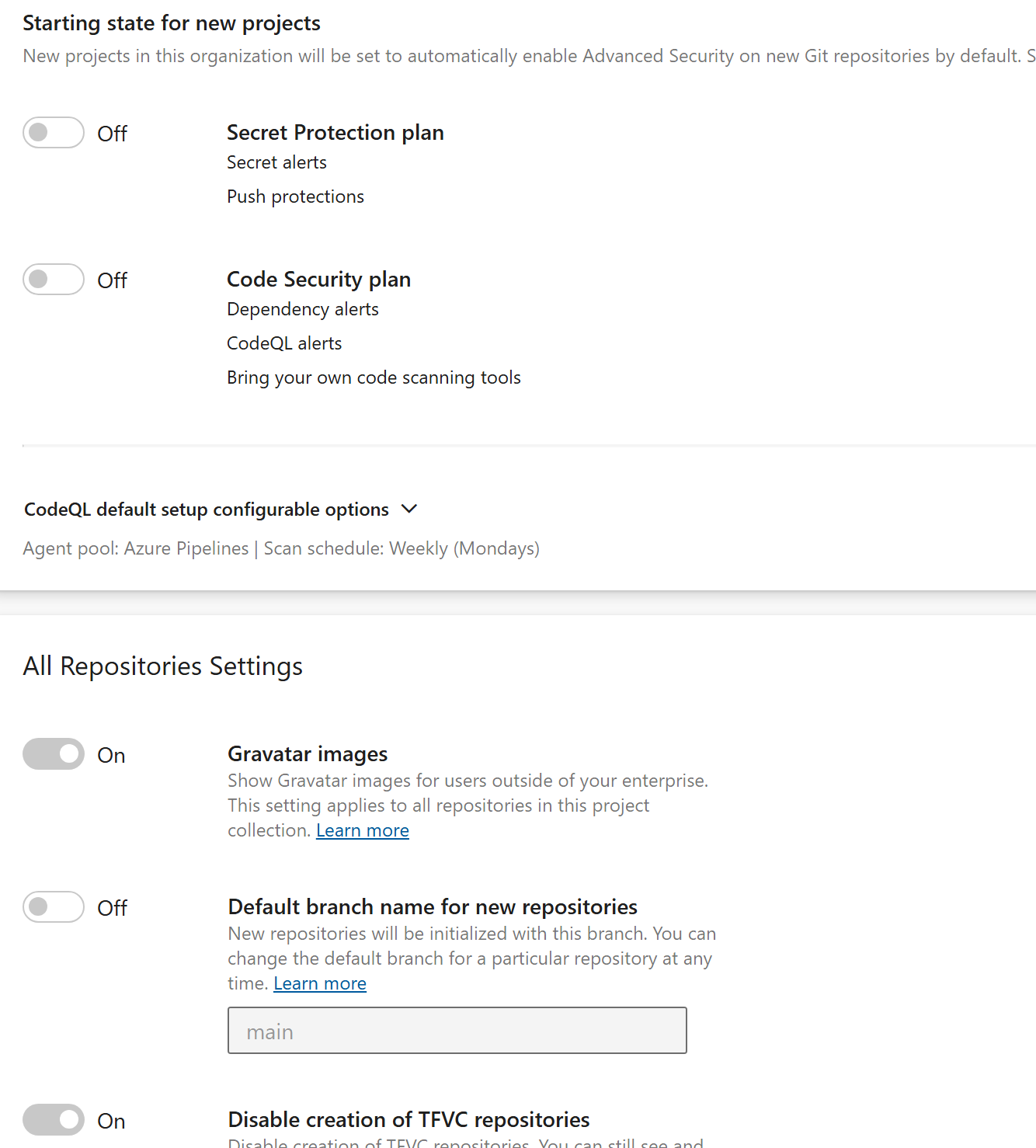

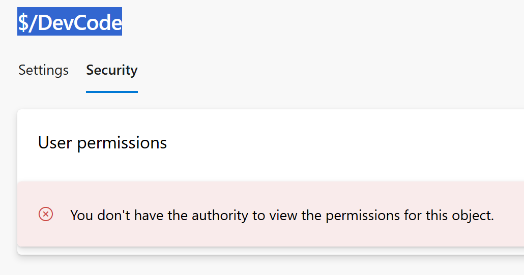

Since you're a Project Collection Administrator, the Repos hub is missing, only the TFVC root (
$/DevCode) is visible, and you're receiving "You don't have the authority to view the permissions for this object," this doesn't appear to be a typical permissions issue.Could you please confirm one additional detail?
