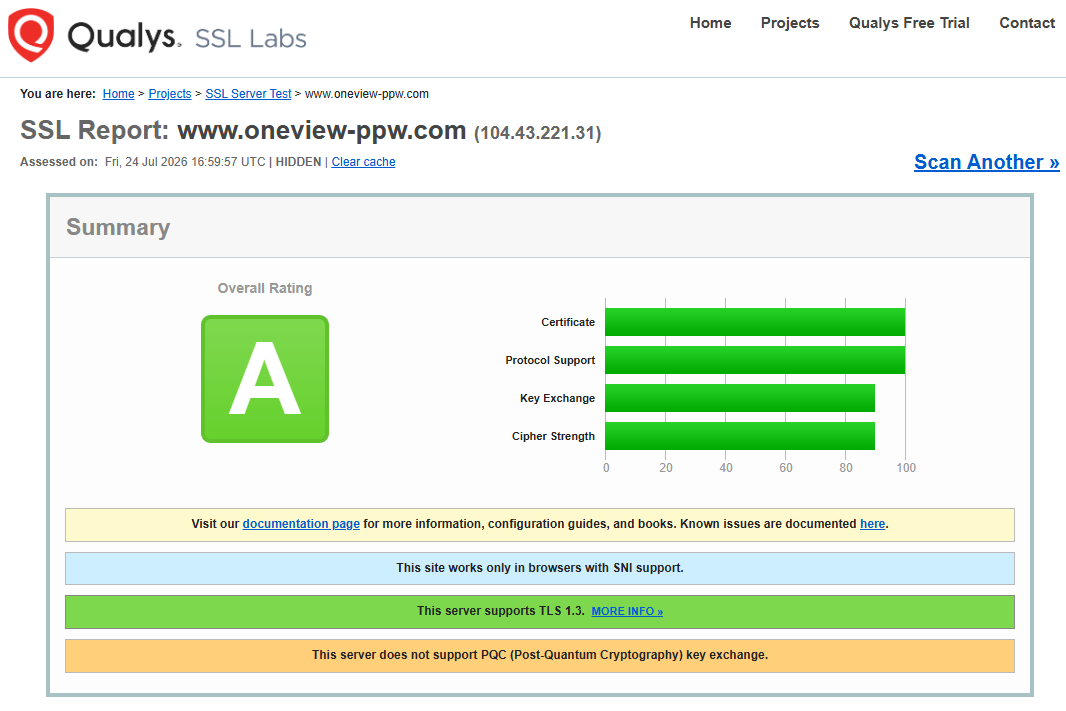

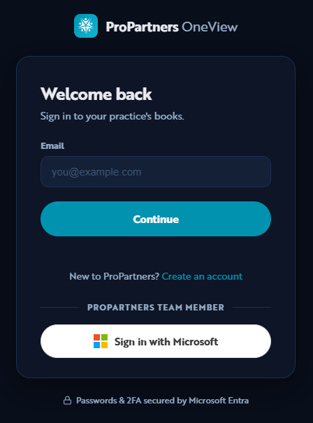

    Does the hang only occur when you try to connect to your site from certain source networks? I ask because I just ran Qualys test on apex as well as www and it succeeded, and tested from multiple browsers and your site displayed fine, with no certificate errors or hangs.
