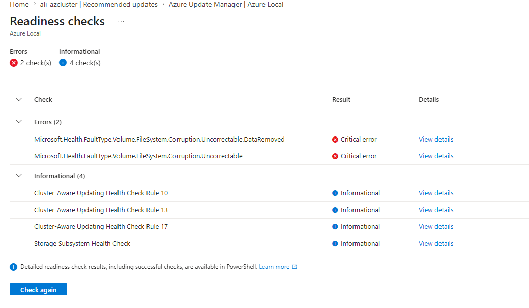

This is for an Azure Local cluster with two nodes. Last weekend, I did Dell Solution Builder Extension version 5.0.2606.1616 update for Manufacturer 16G-45n0c-Intel, Model AX-760, Solution version 12.2606.1003.205, Services version 10.2606.0.7, Platform version 12.2606.0.3008 which completed successfully. After that update, I received the errors below that currently display on the update readiness check and in the Get-HealthFault command but not in the Cluster Alerts menu.
Critical
Cluster ali-azcluster
6 days ago
The file system detected a checksum error and was not able to correct it. The file(s) or folder(s) impacted are \Device\HarddiskVolume10\efd90aec7be9afd\Virtual Machines\Hyper-V\Transcribe\Virtual Machines\183F2A43-6044-444C-82F8-19C73E9BD007.VMRS
Critical
6 days ago
The file system detected a corruption on a file or folder. The file or folder has been removed from the file system namespace. The file(s) or folder(s) impacted are \Device\HarddiskVolume10\efd90aec7be9afd\Virtual Machines\Hyper-V\Transcribe\Virtual Machines\183F2A43-6044-444C-82F8-19C73E9BD007.VMRS
The VM was in a saved state and I could not get it out of that state. In order to delete it and restore from backup, I had to force it out of the saved state via PowerShell. After that, I was able to successfully delete the VM and restore it from backups.
I have manually initiated the Data Integrity Scan scheduled task on both nodes and they return successful with 0x00.
Any suggestions on how to get these critical alerts to clear so that I can proceed with this month's updates?

Based on your description, the affected VM was successfully removed and restored from backup, and the Data Integrity Scan completed successfully (0x00) on both nodes. However, the cluster continues to report critical ReFS checksum and corruption faults through Get-HealthFault, which are preventing the update readiness checks from passing.

  • A screenshot of the Update Readiness report showing the remaining critical alerts

    Your critical ReFS checksum faults remained after deleting and restoring the saved-state VM, although both integrity scans succeeded. Because the cluster later returned to Healthy, this was stale health or readiness state, not evidence that the restored VM still contained the damaged VMRS file.
    Azure Local system health checks run every 24 hours, and portal results can take another cycle to synchronize. Microsoft also documents update-related critical VM alerts that can remain after a successful update and resolve automatically after several days.
    Before the next update, select Check again in Update Manager. Run a prepare-only readiness check and inspect full health-check details. Confirm physical disks, virtual disks, storage pools, and ReFS operational events remain healthy. Never bypass a Critical result. If the same file path returns after a fresh cycle, collect Azure Local diagnostic logs and open Microsoft Support, providing the SBE and solution versions, timestamps, and health output.
