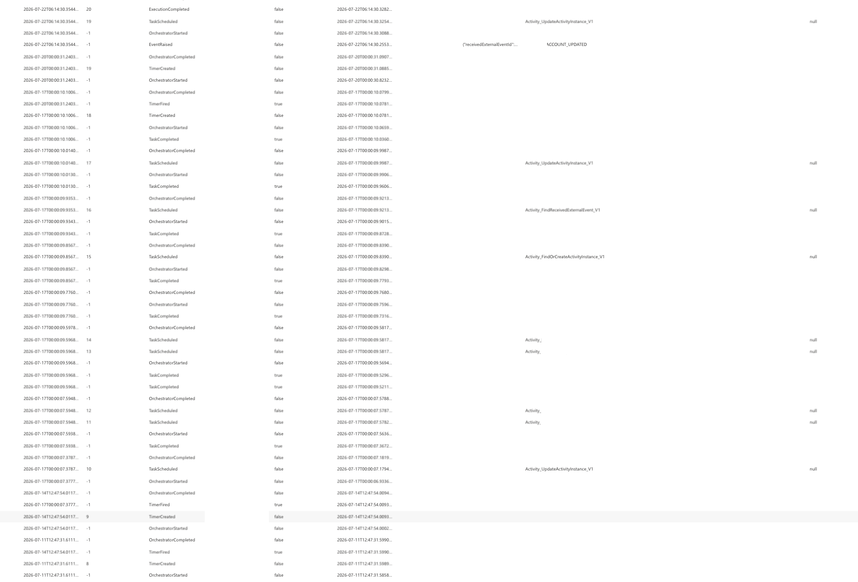

We're running into a non-determinism issue in an Azure Durable Functions orchestration written in TypeScript and haven't been able to identify the cause.
Error
"Non-Deterministic workflow detected: A previous execution of this orchestration scheduled a timer task with sequence number 19, but the current orchestration replay instead produced a ScheduleTaskOrchestratorAction action with this sequence number. Was a change made to the orchestrator code after this instance had already started running?"

using Task.any(). The timeout can be several months in the future, so the Azure Storage provider internally breaks the wait into multiple shorter timer segments, resulting in multiple TimerCreated events in the orchestration history.
When the timeout path is taken, the orchestration replays and continues successfully by executing the Activity_UpdateActivityInstance and subsequent activities without any non-determinism errors. In the attached history screenshot, this can be seen around the TimerFired event above EventId 9.
The issue only occurs when an external event is received. In this case:
  1. Task.any() completes successfully.
  2. resolveWinner() correctly identifies the winning event.
  3. The activity immediately following the wait executes successfully.
  4. After that, the orchestration fails with the non-determinism error. In the attached history screenshot, this happens at EventId 19. From the history, EventId 19 was first associated with the TimerCreated, but after receiving the event, it is linked to the Activity_UpdateActivityInstance (which is the activity immediately following the wait).
We have not modified the code so it can't be related to that.
Can you please help us understand what might be causing this replay mismatch, or point out anything suspicious in the attached history and code?

Christos Panagiotidis 3,551 Reputation points
2026-07-27T09:34:10.3066667+00:00
The suspicious part is the several-month createTimer, not Task.any. Microsoft documents that JavaScript and TypeScript durable timers are limited to six days. Some SDK and storage-provider combinations internally split longer timers into shorter history entries, but that implementation detail is not a substitute for the documented loop pattern. When an external event wins, cancelling the logical long timer after internal segments can make replay action ordering differ from stored history, matching the TimerCreated-versus-ScheduleTask mismatch.
Replace the timer with a deterministic loop. Create external-event tasks once. Each iteration calculates the earlier of timeoutAt or df.currentUtcDateTime plus six days, creates one timer, and races the same event tasks against it. If an intermediate timer wins, continue; if an event wins, cancel only that segment; if the final timer wins, return timeout. Derive every date from df.currentUtcDateTime.
Start new orchestration instances after deployment; existing histories cannot safely replay changed action sequences.
