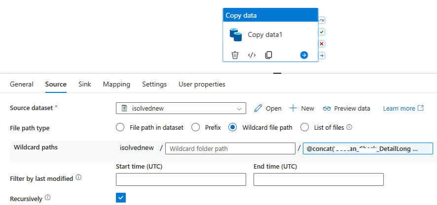

I have an existing ADF pipeline that is creating an error due to some bad (or not acceptable data) displayed on the csv file.
Basically, instead of having proper header on the first row with certain amount columns (with data), csv file displays data like "There is no data to report." on the first row.
Originally, pipeline reads the file name by expression such as bottom inside Pipeline expression builder:
@concat('XXX_Check_DetailPalm Beach Corp' ,formatDateTime(addDays(utcNow(),  pipeline().globalParameters.DifferenceOfDate),'yyyyMMdd'),'*','.csv')
This expression is inside "Copy data".
This original pipeline was working fine until csv file with some weird data shows up that pipeline started failing.

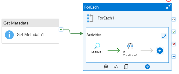

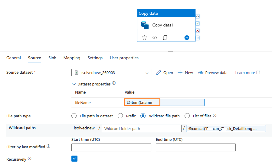

I asked Microsoft Co-pilot to give me some architecture of this logic, and it suggested using first "Get Metadata" to grab "child items", and then use "ForEach" to read each csv files, and then inside "ForEach", I have second "Get Metadata" using a parameter and @item().name, and then, it goes to "If Condition" and "Copy data".
The error happens at "Copy data" (inside If Condition) that it still takes a csv file that has a bad data even though there is an expression that indicates to grab a csv file that has specific column names inside a csv file.

    A better pipeline structure is
    Get Metadata (childItems) > Filter by filename > ForEach > Lookup first row > If Condition > Copy Data

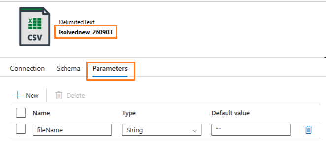

    Inside the loop, use a parameterized CSV dataset pointing to @item().name. Configure the Lookup activity with firstRowOnly = true, but set First row as header to false. This makes ADF return the physical first line as values such as Prop_0, Prop_1, etc., rather than interpreting "There is no data to report." as a column name. Lookup supports returning only the first row of a delimited-text file.

    Keep the Copy Activity’s actual source dataset configured with First row as header = true. Use a separate dataset for the Lookup validation with First row as header = false. Otherwise ADF may interpret the bad message as a header before your condition can validate it.
