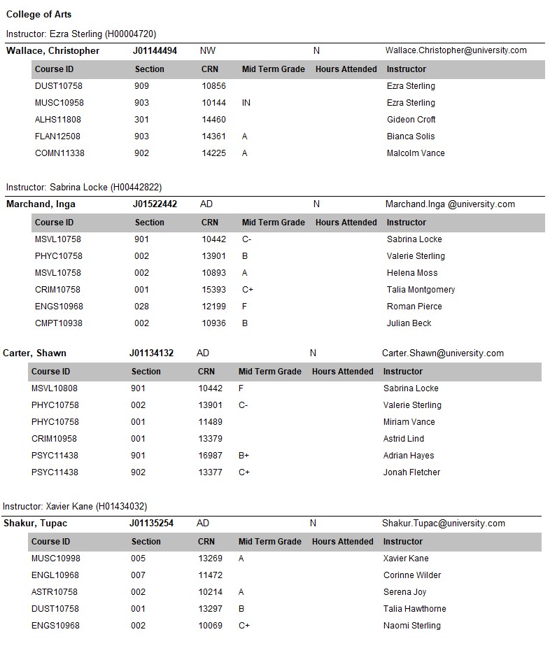

The report currently looks like this. The instructor is shown above the black line. I need to filter out courses under the student that are not this instructor. The 2nd and 3rd students both have a course with Sabrina Locke, so they are shown under the same black line, but I need to remove their courses that are not for Sabrina Locke.
CURRENT

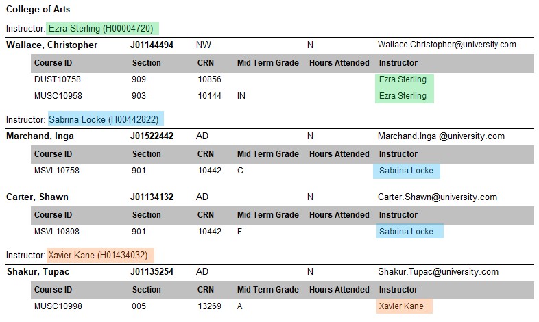

My goal is end up with this result. I highlighted where the values should match. The problem is that the instructor in both areas is being populated by the same field in the dataset.
It seems to me that I need a variable in the instructor cell above the line. I want to compare the courses for each student to that variable and only show the record when the two match.
Is this the best approach? Is this something you can help with?

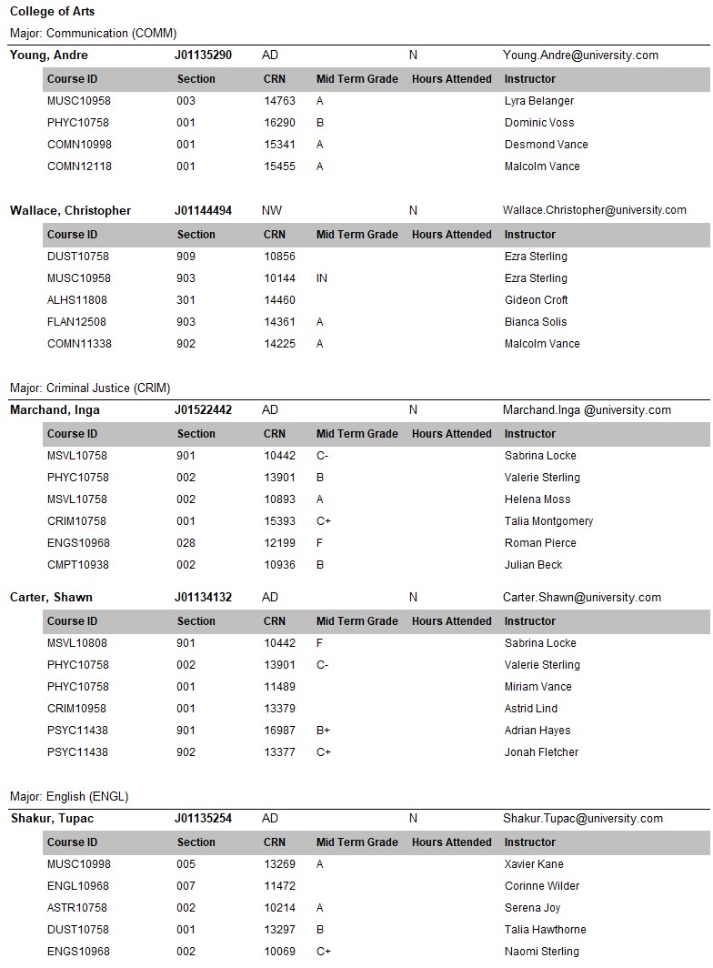

For more context, the report will look like this if they group by the major. This is already correct. I only need it to change when grouping by the instructor.
MAJOR
