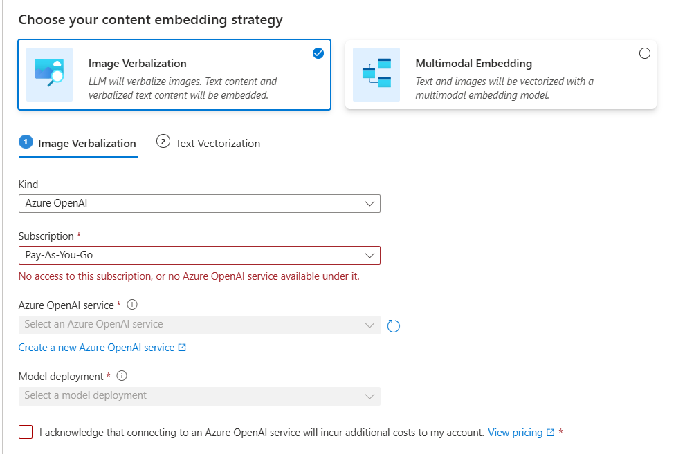

I am currently trying to configure an Index, Indexer, and Skillset (with multimodal support) in Azure AI Search using the Import Data wizard. During the setup process, I need to connect my existing Azure OpenAI resource. There is also a model deployed. The AI Search service and the Azure OpenAI resources are created in the same region.
However, when I try to select my Azure OpenAI service from the dropdown, it is greyed out, and I receive the following error message beneath the Subscription dropdown:
"No access to this subscription, or no Azure OpenAI service available under it."
Here are the details of my environment:
  • I am using a Pay-As-You-Go subscription.
  • I have already created an Azure OpenAI service and deployed models within this exact same subscription.
  • I am the Owner/Contributor on the subscription and have the necessary Cognitive Services roles.
  • Both the Azure AI Search service and the Azure OpenAI service are active.
Why is the wizard failing to detect my existing Azure OpenAI resource, and how can I resolve this so I can complete my skillset configuration? Could this be related to region mismatch, RBAC propagation delays, or specific network/firewall settings?

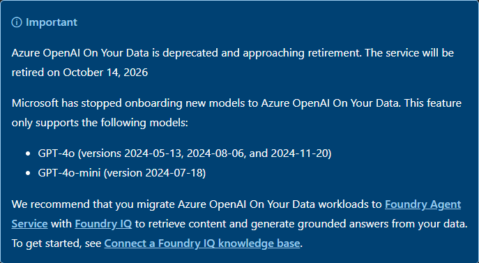

    6. If using Azure OpenAI On Your Data role-based access patterns, confirm role assignments are correct For Search-to-OpenAI access, the documented role is Cognitive Services OpenAI Contributor assigned to Azure AI Search on the Azure OpenAI resource. In a related resolved case, the search service managed identity had been added to the wrong Azure OpenAI resource, which caused skillset creation failure.
