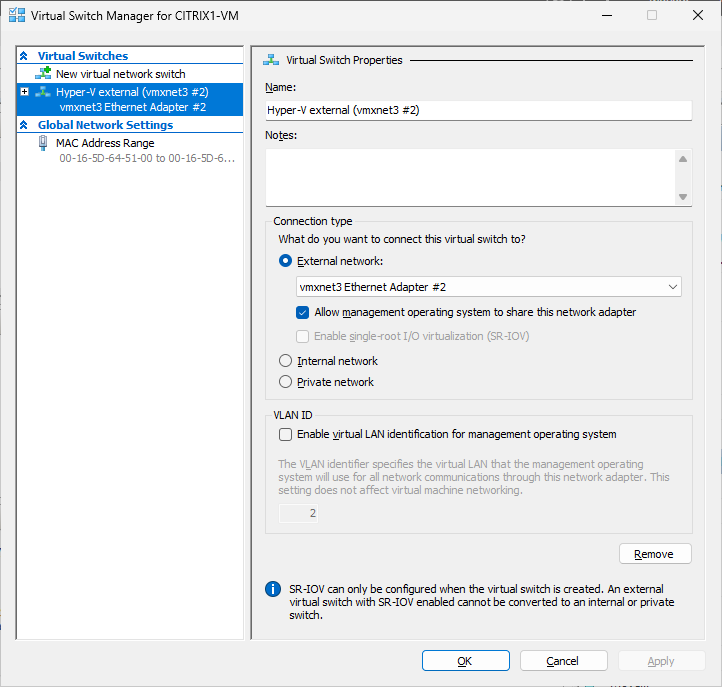

I'm working on a PoC Citrix installation. There's a "Windows Server 2025" VM (running on "VMware", with all CPU virtualisation features exposed to the VM), on which I've installed the "Hyper-V" role and "Network Virtualization" feature (required so it can be managed by "System Centre 2025"'s "Virtual Machine Manager"). I've created an "external" switch within "Hyper-V", which is bound to the second network card in the "Windows Server 2025" VM:

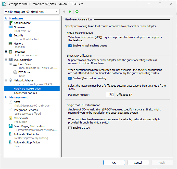

As you can see, SR-IOV is disabled at the switch level. I've created some VMs, all of which have SR-IOV disabled at the VM level; E.g.:
All other settings are left at their default values (E.g., "Enable virtual machine queue"), though I have changed the dynamic MAC address range so as not to cause any potential conflicts with any other "Hyper-V" hypervisors on the network.

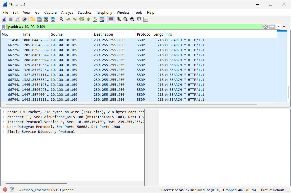

However, what makes this really weird is that, with a manually assigned IP address, I do see SSDP traffic from that VM going out over the server NIC:
(10.100.10.109 is the address I manually assigned to the VM).
So it's really, really weird - only SSDP traffic is making it off the VM and onto the LAN - literally everything else (including DHCP packets...) is getting lost somewhere.
