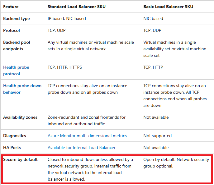

Did you allow the required inbound port(s) in the Network Security Group (NSG)? One key difference with Standard Load balancer is it is secure by default, whereas basic is open by default. This means if using Public Standard Load Balancer the traffic needs to be allowed by NSG.
For example, if your management software platform is web based then you would typically need to allow TCP port 443 in the NSG.
Below is screenshot excerpt from documentation comparing Basic vs Standard:
