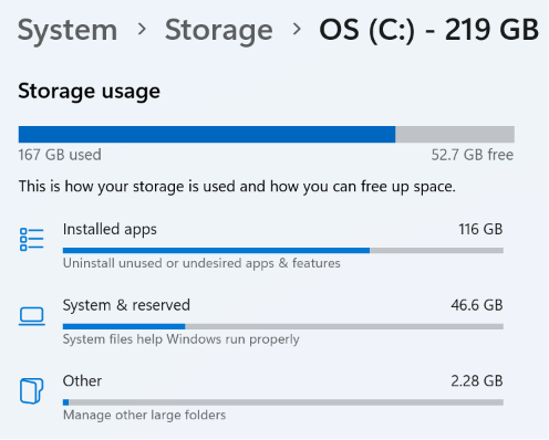

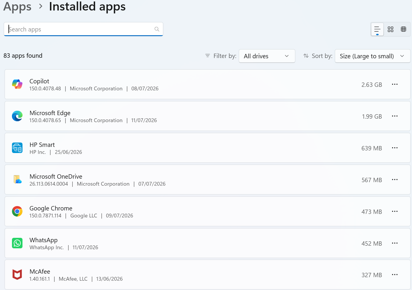

I have a Dell laptop with a 250GB SSD drive. I have very few files saved on this - all are saved to a 64GB USB dongle. I have been getting 'low on memory' messages for the last month. I have a total of 115GB of Installed Apps but cannot see how this is so large. I can see there are a total of 81 Apps, but only two are larger than 1 GB. Most are very small. I cannot understand where all the 100GB + storage is being usedCan someone advise? It's now a huge issue as I'm no longer able to run more than a single programme due to the lack of disk space.
