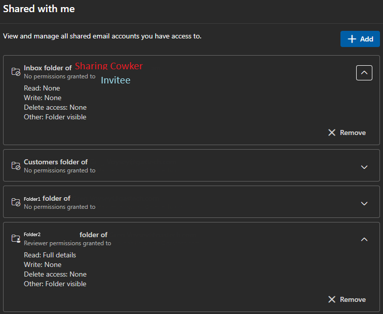

A user is trying to share a single folder to several coworkers. The share permissions have all been applied to a single folder and are provided as a Reviewer (Full Read only) permissions.

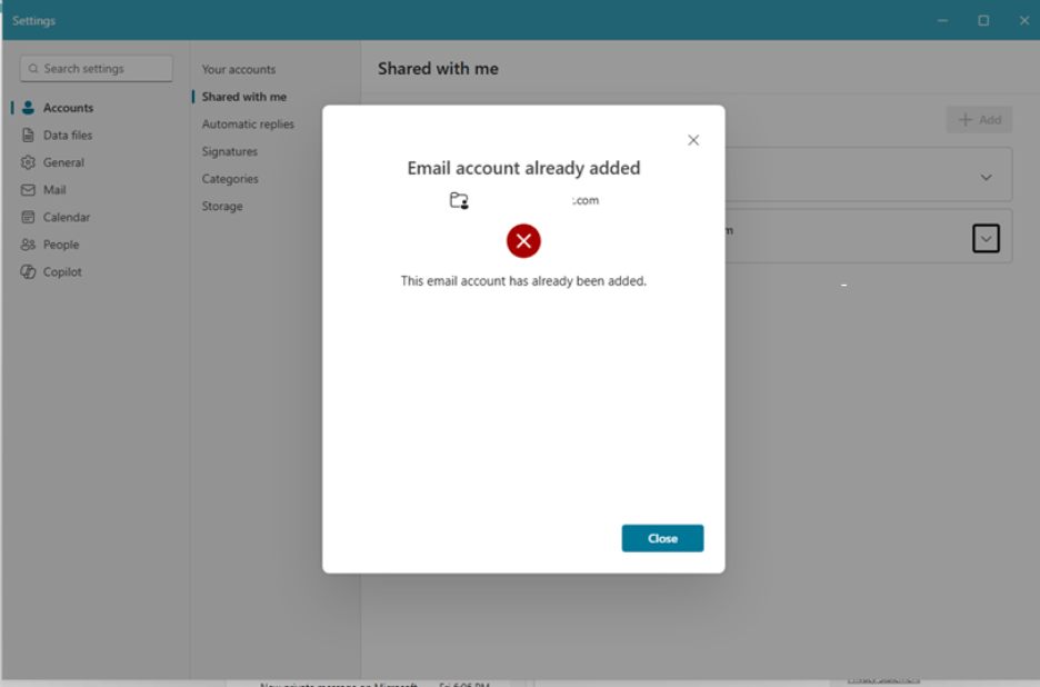

Invitees have been trying to add the Shared Folder by following the guides found here: Open and use a shared mailbox in Outlook, however we are consistently getting an error that claims that the email account has already been added to Outlook.
This has been verified with three different users, on three different Windows 11 machines. All users are full Standard License accounts and the machines are all Windows 11 Pro.
The Shared Folder/inbox is evidently being recognised by New Outlook but does not display in the inbox of the invitee.
Notably when Outlook is restarted, the Shared Folder disspears from the 'Shared with me' pannel.

I actually tried to reproduce the same scenario in my own test environment, and I observed very similar behavior. The shared folder could be accessed correctly through Outlook on the web, but the experience in the New Outlook desktop app was inconsistent:
User's image User's image
Based on my testing and experience, I am inclined to think this may be a limitation or known behavior within the current New Outlook experience rather than a problem with the folder permissions themselves. The fact that everything works as expected in Outlook on the web suggests that the sharing configuration is likely correct and that the issue may be related to how the New Outlook client processes or synchronizes shared folders.

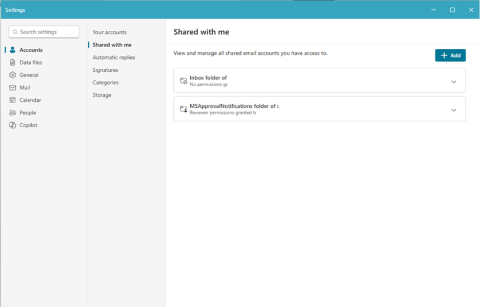

I spent some additional time researching and testing potential workarounds, and I did find one approach that worked on my side.
After granting the folder permissions, I first added the shared folder through Outlook on the web. The folder appeared successfully there, and I was able to verify that all permissions were applied correctly.
Next, in the New Outlook desktop application, I removed my account from the app and then added it back. After the account was reconnected, Outlook performed a fresh synchronization, and I found that the desktop client started reflecting the same shared folder configuration that was already visible in Outlook on the web.
You may want to give that a try and see whether it produces the same result in your environment.
