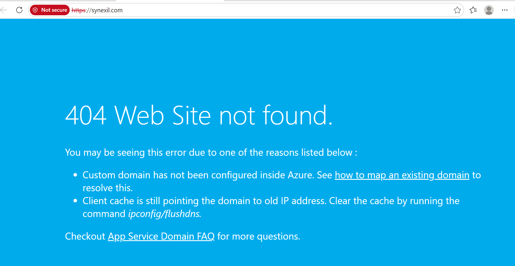

I need help in getting past this stage,
I have created a static web app on my MCT Azure subscription, my custom domain has been added to a different M365 tenant, but I added the custom domain to my Azure using the "custom domain on other DNS" option, I added the CNAME record provided by Azure on my DNS provide, and the custom domain was validated on Azure, it's been over 72 hours, and Azure is yet to provide the ALIAS record to make me complete this configuration. I will appreciate help from the experts. Kind regards.

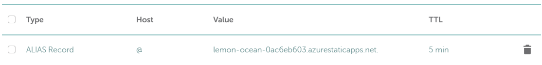

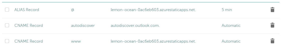

    Please sign-in to your Namecheap account and add ALIAS record, as below:
    Type: ALIAS Record
    Host: @
    Value: lemon-ocean-0ac6eb603.azurestaticapps.net
    TTL: Automatic
    After saving the new record, please wait 2-3 minutes and then test your site using web browser.

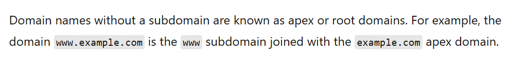

    Thank you for reaching out Microsoft Q&A. It looks like domain verification failed. In the provided screenshot comprises of your apex domain "synexil.com"
