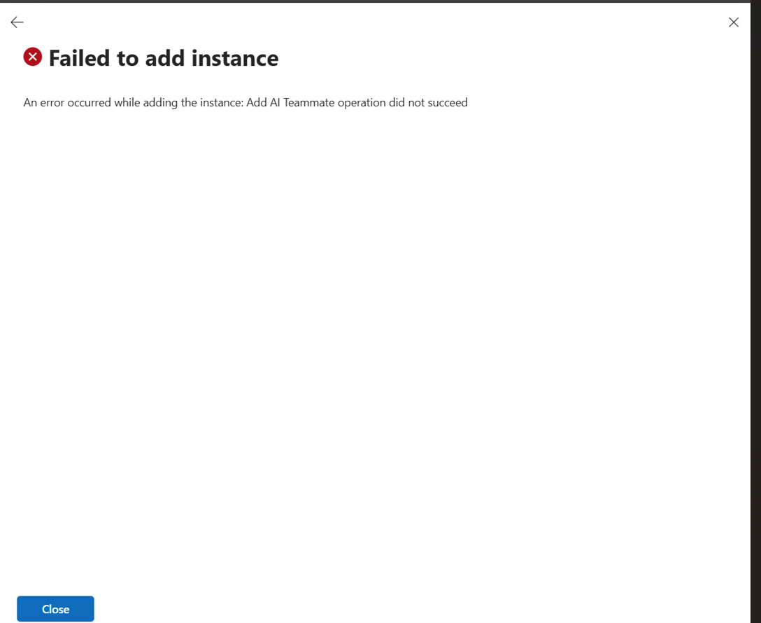

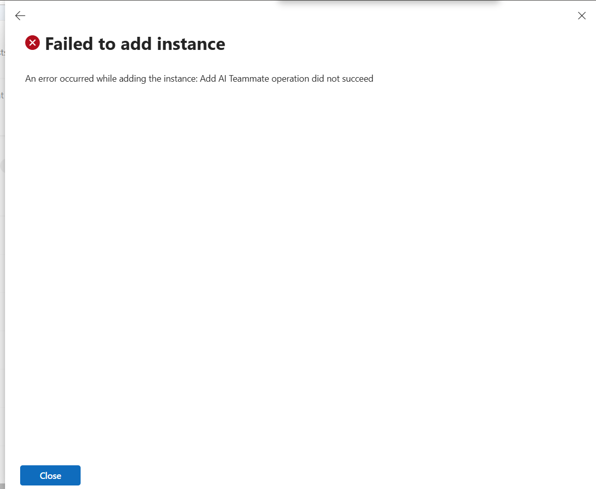

But, after uploading the agent ZIP and creating an agent instance from the blueprint, we are getting the following authentication error:
Unhandled rejection Error: Token request failed with status 400: {"error":"invalid_grant","error_description":"AADSTS50034: The user account {EUII Hidden} does not exist in the <tenant id> directory. To sign into this application, the account must be added to the directory. Trace ID: 5405ebba-13ff-4740-9919-e39443a56200 Correlation ID: e948f327-da45-45ef-b834-cf653f524923 Timestamp: 2026-06-30 17:17:03Z","error_codes":[50034],"timestamp":"2026-06-30 17:17:03Z","trace_id":"5405ebba-13ff-4740-9919-e39443a56200","correlation_id":"e948f327-da45-45ef-b834-cf653f524923","error_uri":"https://login.microsoftonline.com/error?code=50034"}
