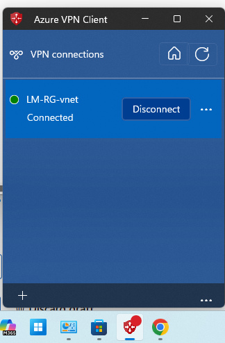

My business runs Azure VPN Client in Windows 11 Pro, and I'm running it on my Surface Pro for Business 11th Ed. I keep the Azure icon in my Taskbar for easy access and visibility into the status of the connection. But the status indicator in the Taskbar rarely matches the actual status of the VPN Client. E.g., you'll see in the photo below that my Taskbar currently shows red (not connected), but the Client app correctly shows green -- my PC is connected to Azure. The same problem occurs in reverse, too; the Taskbar indicator often shows green even though the VPN Client is not connected.
After the usual reinstall/restart steps failed, I asked my IT consultant to try to fix this. He concluded that the problem originates within Microsoft's UI and there's nothing he can do. This is a big time-waster and cause of frustration. Please help.

I looked into this and your IT consultant's diagnosis lines up with what I found. This is not something wrong with your VPN connection itself, it is a known category of issue where Windows caches the taskbar notification area icon state and does not always redraw it in sync with the app's actual status. The Azure VPN Client updates its tray icon using the standard Windows Shell_NotifyIcon mechanism, and Windows 11's notification area is known to hold onto a stale bitmap for an icon until something forces a repaint, especially after sleep or resume, after Explorer restarts in the background, or when the icon has been moved between the visible tray and the overflow "hidden icons" area. That explains why the mismatch goes in both directions rather than always failing the same way.

    Hi @Jerald Felix , unfortunately my IT consultant ran through all of these suggestions with no success, and has now submitted a report and screen recording to the Feedback Hub. He didn't seem optimistic about getting a response from Microsoft there, but I will update here if he does. I appreciate your detailed guidance, though.
