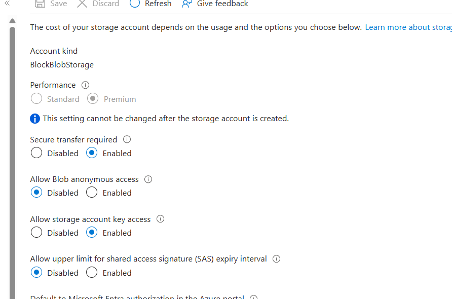

We couldn't find option to migrate to GPV2 for "Blockblobstorage" Kind for a premium account
2026-07-01T10:10:06.38+00:00
Hello Team, Please let us know how to migrate "Blockblobstorage" Kind premium account to GPV2. Please provide steps.Thank you!Screenshot 2026-07-01 153532

There's no built-in capability to migrate from Premium BlockBlobStorage account to General Purpose v2 (StorageV2) account. To migrate you will first need to create the destination StorageV2 account, add Azure RBAC role assignments, configure account, and then use AzCopy to copy all the containers, directories, blobs over from the source to destination.
Once you have verified everything has copied over successfully you can delete the source account.
For example, below is sample command from AzCopy documentation to copy containers and blobs:
azcopy copy 'https://mysourceaccount.blob.core.windows.net/' 'https://mydestinationaccount.blob.core.windows.net' --recursive
Copy blobs between Azure storage accounts by using AzCopy
https://learn.microsoft.com/en-us/azure/storage/common/storage-use-azcopy-blobs-copy
NOTE: You do not have to migrate your BlockBlobStorage account. It is NOT a legacy blob storage account and as such is unaffected by the October 2026 retirement deadline.
