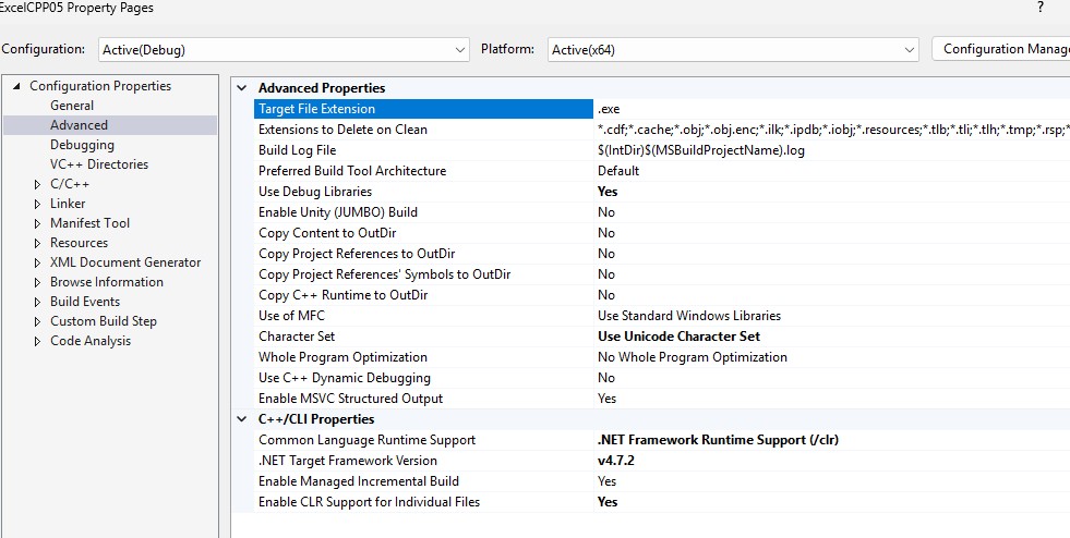

    Following Bruce's idea, you may want to try the Open XML SDK from C++/CLI. I tested a small project and it built and ran fine, with no COM and no #import problems.
    Setup that worked for me:
    • A C++/CLI console project with CLR support on (/clr), targeting .NET Framework 4.8.
    • References: System, System.Data (for ODBC), WindowsBase, and DocumentFormat.OpenXml.dll (version 2.20.0, the net46 build, which needs no extra packages).
