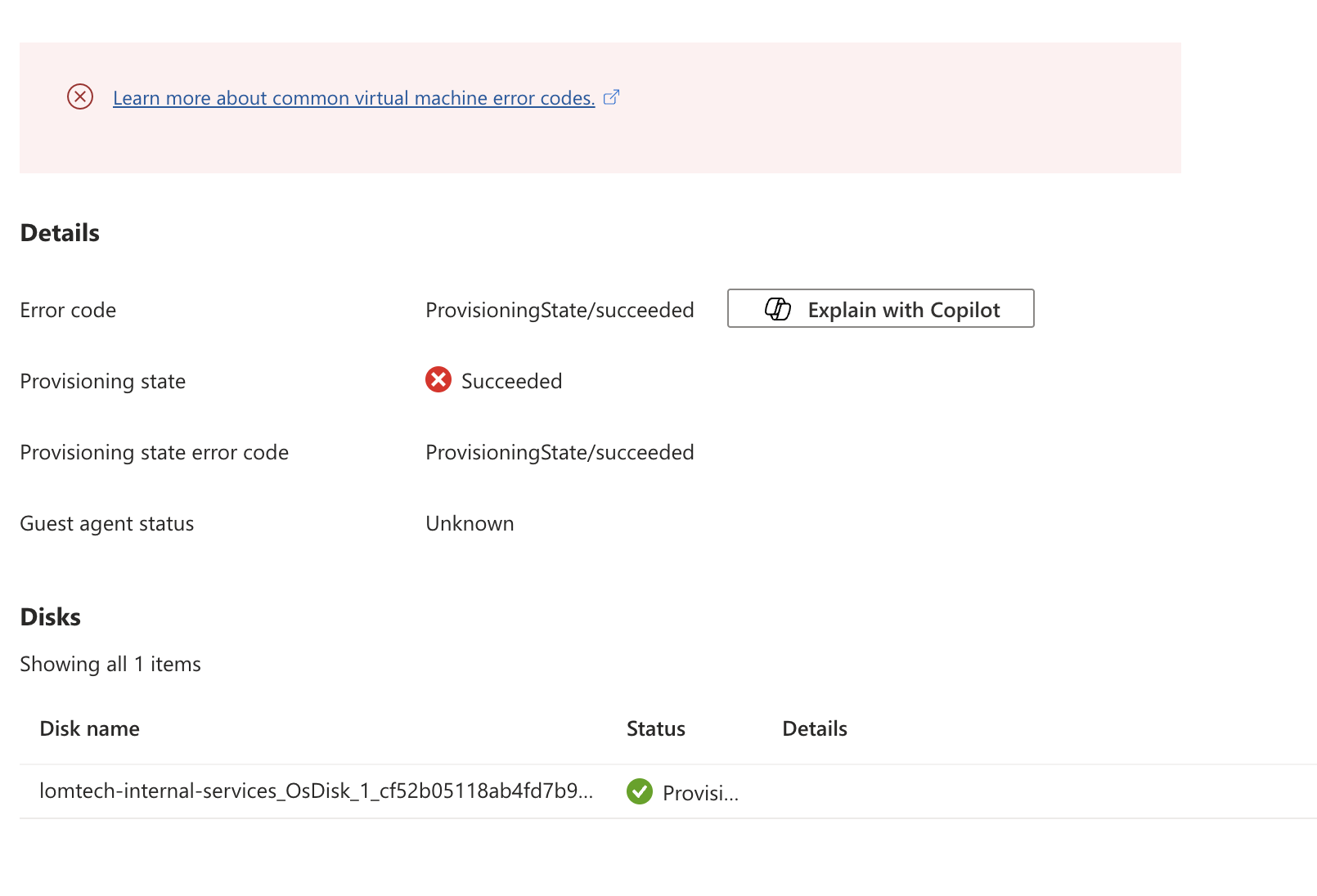

Hello Azure Support Team,
I am currently experiencing an issue where my virtual machine fails to start. Here are the exact steps I took before encountering this problem:
I stopped (deallocated) the server instance.
I increased the disk size from 128GB to 256GB.
I attempted to start the server again, but the operation failed.
Could you please guide me on how to resolve this issue and get the server running again?Screenshot 2026-06-29 at 4.04.10 PM
Thank you for your time and assistance.

Hi Brandon,
Based on the error you received there was not enough physical host capacity in the Azure availability zone to allocate to your VM so that it could start. This has nothing to do with you resizing the OS disk.
What I recommend is to periodically try to Start the VM over the next several hours until it succeeds. If you keep trying without success and can no longer wait for more capacity to free up, what you can do is try resizing to different size family, or re-create the VM in different availability zone. For example, say the current VM size uses Intel CPU, try resizing to equivalent size using AMD instead.

  2. Alex Burlachenko 25,290 Reputation points MVP Volunteer Moderator
    2026-06-29T09:28:44.8766667+00:00
    Brandon Lee hi & thx for sharing urs issue here at Q&A portal,
    Disk resize itself usually shouldn’t stop a VM from starting.
    From the screenshot, the OS disk provisioning succeeded, but the guest agent is Unknown. So the problem is likely boot/guest OS side, not the disk resize operation.
    Check Boot Diagnostics and Activity Log for the failed Start VM operation. That should show the real error.
    https://learn.microsoft.com/en-us/azure/virtual-machines/boot-diagnostics
    https://learn.microsoft.com/en-us/azure/virtual-machines/troubleshooting/serial-console-overview
    If it still won’t boot, use a repair VM and attach the OS disk there to inspect logs/filesystem. Don’t delete the VM or disk.
    rgds,
    Alex
