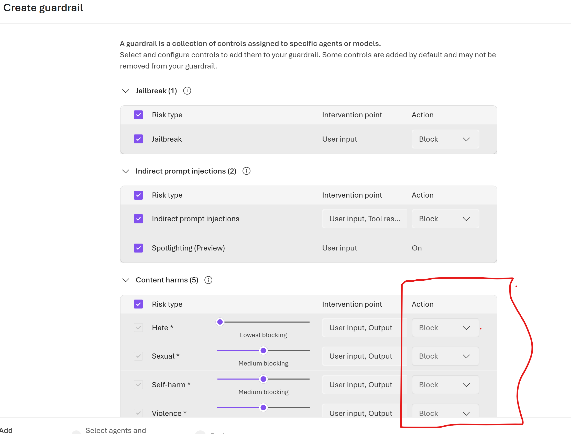

Is it possible to set "Annotate" action for the risk types under the content harms when creating a new Guardrail in the new Foundry service.
Right now, I can only see "Block" as the Action as seen the picture below.
Thanks in Advance

    This is a great question and the behavior you are seeing in the new Foundry Guardrails portal is by design. Let me explain why and then walk you through how to get annotation-only behavior if that is what you need.
    Why the portal only shows "Block" for harmful categories:
    For the four core harm categories, which are hate, sexual, violence, and self-harm, the portal lets you configure severity thresholds (Low, Medium, High) and content is annotated by each category and blocked according to the threshold. The design intent for these core categories is that blocking is the primary enforcement action. The threshold slider is where you control sensitivity, not the action type.
    Some filters, such as Prompt Shields and Protected material detection, enable you to determine if the model should annotate and/or block content, which is why you see the "Annotate" option available for those risk types but not for the core harmful categories in the portal UI.
    However, annotation mode is fully supported for harmful categories at the API level:
    Annotations can be enabled even for filters and severity levels that have been disabled from blocking content. Optional model annotations can be set to annotate mode (returns information when content is flagged, but not filtered) or filter mode (returns information when content is flagged and filtered).
    This means if you want "Annotate only" behavior for harmful categories (detect and flag in the API response without actually blocking the content), you need to configure this through the REST API rather than the portal UI.

    Setting "blocking": false while keeping "enabled": true is what activates annotate-only mode. The guardrail will detect and flag content in the API response without blocking the request.

    The Foundry portal currently surfaces "Block" as the only action for harmful categories by design, since blocking is the recommended enforcement mode for those risk types. Annotate mode returns information when content is flagged, but not filtered, and this is configurable via the RAI Policy REST API by setting blocking: false. This gives you full annotation visibility without the content being blocked, which is useful for monitoring, auditing, or building custom moderation workflows on top of the detection results.
