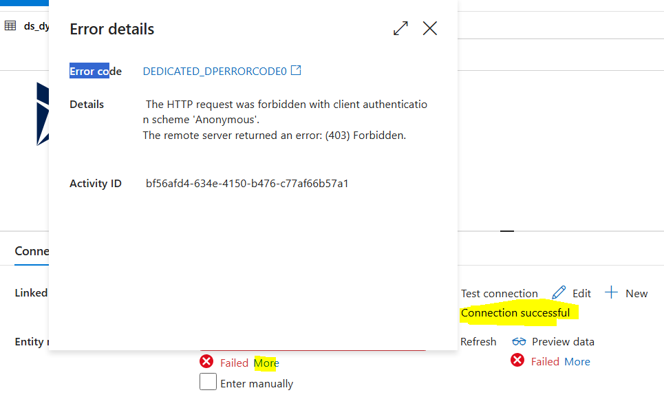

I am encountering the following error while trying to create a dataset using the Dynamics 365 connector in Azure Data Factory (ADF) although Linked service connection successful:
"The HTTP request was forbidden with client authentication scheme 'Anonymous'. The remote server returned an error: (403) Forbidden."

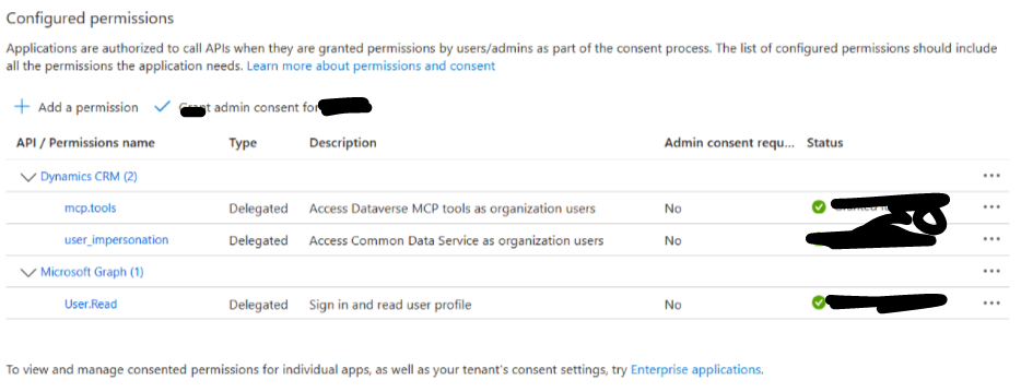

  1. API permissions are given for this App User for Dynamics365
  2. User is a systemadmin
Could you please help identify if there are any additional permissions, authentication settings, or ADF-specific configurations that might be causing this issue?

    linked service test passing only proves ADF can get a token/connect. Creating the dataset makes another Dataverse metadata call, and that call is getting treated as anonymous or isn’t getting the token in the way the connector expects.

    The app registration needs to exist as an Application User inside that Dataverse environment, with the right security role. System Administrator is enough for testing, but make sure it’s assigned to the application user object, not only to ur normal user account. This is the bit that gets missed a lot.

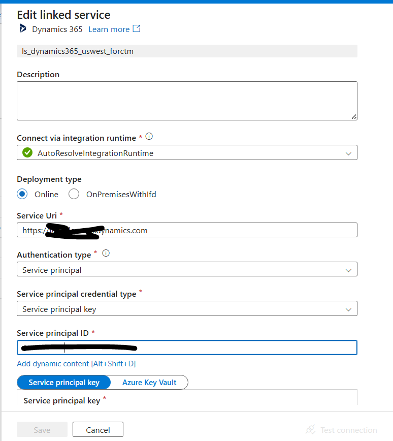

    Since the Linked Service connection test succeeds and the same endpoint works successfully in Postman, the issue appears to be related to how Azure Data Factory is authenticating or authorizing access when retrieving entity metadata during dataset creation.
    Could you please help verify the following:
    • Which authentication type is configured in the Linked Service (AAD Service Principal, Managed Identity, or Office 365)?
    • If using a Service Principal, please confirm that an Application User has been created in the Dataverse/Dynamics environment and that it has the required security roles assigned.
    • Verify that the configured serviceUri exactly matches the Dynamics 365 URL used in Postman and the browser (for example: https://fort-dev.crm.dynamics.com).
    • If Office 365 authentication is being used, please confirm whether Conditional Access or MFA policies are enabled in the tenant, as these scenarios require Microsoft Entra Service Principal authentication.

    • A screenshot of the Linked Service authentication configuration (excluding any sensitive information).
    This information will help determine whether the 403 response is related to Dataverse application-user permissions, entity-level security, or the authentication method being used by ADF.
