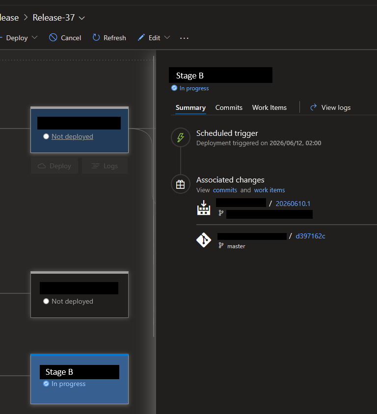

I have a classic Azure DevOps release pipeline (Pipeline A) where Stage B is configured to deploy at 02:00 after an earlier stage (Stage A) has completed successfully.
On multiple occasions across multiple releases, Stage B transitions to “In Progress” / “1 pending” at the scheduled time, but the deployment job never actually starts on the target agent. The stage then remains stuck indefinitely until I manually intervene later in the morning. If I manually cancel/redeploy the same Stage B deployment in the same release at around 07:30, it runs successfully on the same target agent without any pipeline/task changes.

  • Pipeline A shows Stage B as In Progress

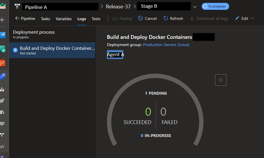

  • Stage B shows 1 pending

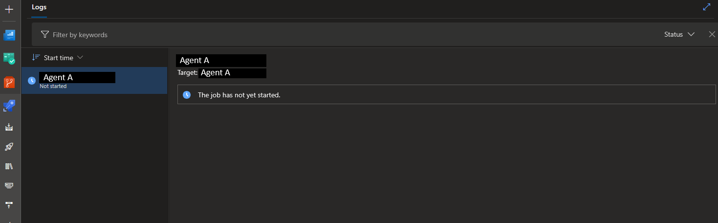

  • The job view shows “The job has not yet started”
  • No task logs are produced for Stage B because the job never actually starts

  • Stage B’s trigger fires correctly at 02:00. The issue is not that the trigger fails to fire; the stage enters an “in progress / pending” state as expected.
  • Stage B uses a Deployment Group job (not a standard Agent job).
  • Only one deployment target / agent is intended to run this stage:
    • Deployment target: Agent A
    • Targeting is done via deployment group tags configured on Stage B.
  • There are no other release pipelines using the same deployment group / target agent at the time the trigger fires.
  • Agent A remains online and healthy during the failure window.

  • During the failure window, there is no log entry indicating that Stage B’s job was assigned to Agent A.
  • If I manually cancel/redeploy the stuck Stage B deployment later in the morning, it succeeds immediately using the same deployment target / agent and same release definition.
