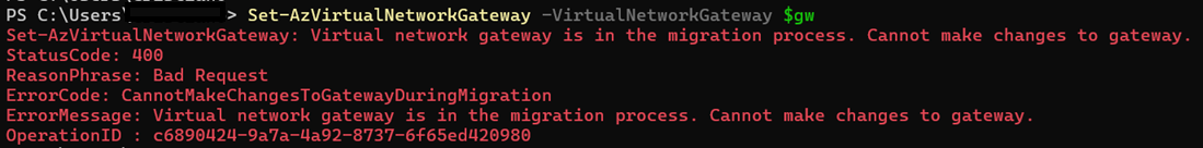

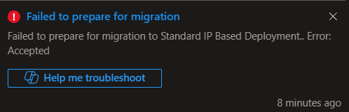

I need to migrate the IP of my Virtual Network Gateway (Sku VpngGw1, Active-Active, P2S and S2S as well) since the action is required by June 30th, and all of the IPs are Basic, so it gives me trouble when I go in the portal Settings > Configuration > Migrate to Standard IP and try to prepare the Migration:
I tried to follow the procedure with powershell but it did not work properly and returned me this:
Invoke-AzVirtualNetworkGatewayPrepareMigration: The migration input passed in for Virtual network gateway /subscriptions/subscription-code/resourceGroups/CompanyResources/providers/Microsoft.Network/virtualNetworkGateways/MyGateway is not valid for a Gateway with active active setting and a point to site configuration
StatusCode: 400
ReasonPhrase: Bad Request
ErrorCode: InputIpResourceUrlNotValidForActiveActiveGatewayWithP2S
ErrorMessage: The migration input passed in for Virtual network gateway /subscriptions/subscription-code/resourceGroups/CompanyResources/providers/Microsoft.Network/virtualNetworkGateways/MyGateway is not valid for a Gateway with active active setting and a point to site configuration
OperationID : P11
Unfortunately I was thrown into this with no knowledge of VPNs, gateways or Azure matters, so I am begging for help since I am lost on what the next step for me will be.
Thank you in advance for the help, please do ask me if you need extra info on my end.
