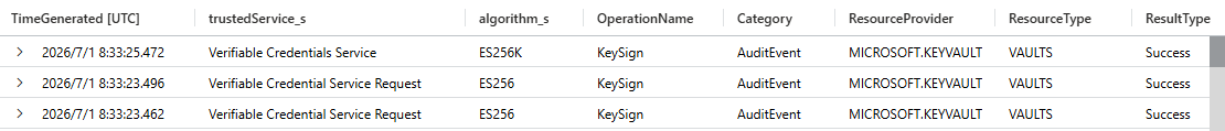

    Thank you for the additional details and the Key Vault audit logs.

    However, the audit logs and issued VC headers indicate that credential issuance is still using the legacy P-256K signing key (alg: ES256K).
