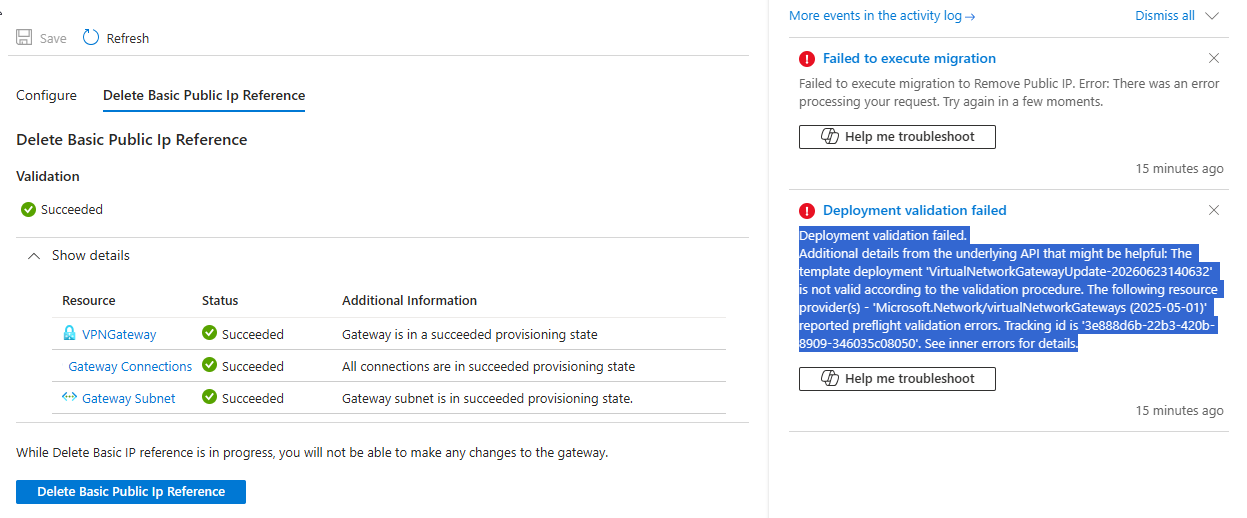

Trying to perform the 'Delete Basic Public IP Reference' to complete the migration as per Microsofts doco, and it fails with the error below even though validation page shows 'succeeded' for all resources. I've run it three times now over the last few days.
Deployment validation failed.** **Additional details from the underlying API that might be helpful: The template deployment 'VirtualNetworkGatewayUpdate-20260623140632' is not valid according to the validation procedure. The following resource provider(s) - 'Microsoft.Network/virtualNetworkGateways (2025-05-01)' reported preflight validation errors. ****
There's been two tracking id's provided so far. First run it gave tracking id 'ecf169a4-8b8e-4895-b920-f5e8b411796d'. Every subsequent run gives tracking id '3e888d6b-22b3-420b-8909-346035c08050'.
No idea how to resolve this or even if I need to?

This is a known issue that several customers have encountered. The "Deployment validation failed" error with a Microsoft.Network/virtualNetworkGateways preflight validation failure, even when the validation page shows all resources as Succeeded, typically indicates a stale or conflicting configuration on the gateway that the template deployment is tripping over during the actual apply step, even though the pre-check passes cleanly.

Community reports confirm this error has been intermittent for some gateways and resolved on its own after a few days, likely due to backend platform fixes rolling out. The fact that you received two different tracking IDs suggests the backend may be returning different error conditions on each attempt. Waiting 24 to 48 hours and retrying once more is a reasonable step before escalating.
Step 5: Open an Azure Support ticket (required for your situation).
Given you have run this three times across multiple days and have two distinct tracking IDs, this is the appropriate path. The tracking IDs you already have (ecf169a4-8b8e-4895-b920-f5e8b411796d and 3e888d6b-22b3-420b-8909-346035c08050) are valuable and should be included in the ticket so the networking team can look at the backend preflight validation logs to identify the exact cause.
