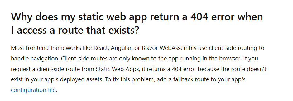

- Optional) Validate SPA routing If you’re using frameworks like React, Angular, or Vue, please ensure your app has proper fallback routing configured (for example, using
navigationFallbackinstaticwebapp.config.json). This is a common secondary cause of 404 for client-side routes
