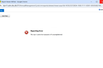

We cannot run a custom report created in the report wizard. The standard reports seems to be working.
We have the same solution running on TEST and Develop servers, where we dont get error.

    like you’re hitting an SSRS authentication issue specific to custom reports in Dynamics 365 (Customer Engagement) 9.1 on-prem: the out-of-the-box reports work, while the custom report created in the report wizard fails. That pattern commonly points to a Kerberos/SSPI double-hop / SPN problem, where SSRS can’t authenticate successfully when the report is executed using the Dynamics FetchXML/report flow.
