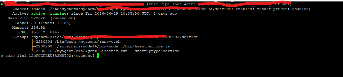

Although I've been utilizing Azure Devops services for some time, I recently discovered a Node16 vulnerability.I am aware that it has reached its end of life. Therefore, I would like to know if I can use node 20 or 24 instead of 16 in the configuration file (runsvc.sh) and then remove the v16 that comes with

Step 2: Verify the agent is now using Node 20 to run its service
After the upgrade, check the service logs or run:
sudo systemctl status vsts.agent.<orgname>.<poolname>.<agentname>.service
You should see output like ./externals/node20_1/bin/node ./bin/AgentService.js in the process tree, confirming the agent service itself is now running on Node 20.

    Yes, you can move away from Node 16 on Azure DevOps agents, but you generally shouldn’t just “swap Node binaries” in runsvc.sh without understanding how the Azure Pipelines agent selects its Node.js “task runners”.

    This avoids relying on whatever runsvc.sh happens to launch (which in your screenshot appears to be starting the agent’s listener using externals/node16/bin/node ...).
