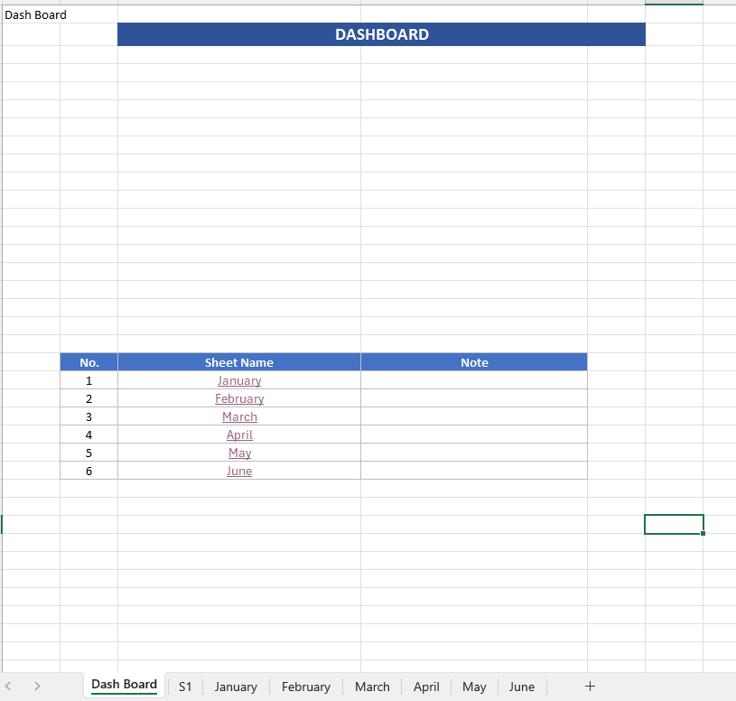

Hello - I have the below macro for duplicating the sheets from the list present in sheet called "Dashboard".
Al the sheets are dulicated sucessfully.
I want that the duplicated sheet also be hyperlinked with the list present in sheet name "Dashboard".
Please update this marcro with this above request that each content of the list must be hyperlinked with the respective sheets name.
The macro is as below

2026-06-21T09:45:56.92+00:00
Hi @Chaturvedi, Santosh,
I took some time to recreate your scenario based on what you described and tested it in my own environment, and it seems to be working as expected.
You can try using the macro below to achieve what you’re looking for, where each item in the list on the Dashboard sheet is also hyperlinked to its corresponding duplicated sheet:

If it doesn’t work as expected or you run into any issues, feel free to get back to me anytime. I’d be happy to take a closer look and work through it together with you if needed.
Thank you for your patience and cooperation.
