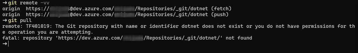

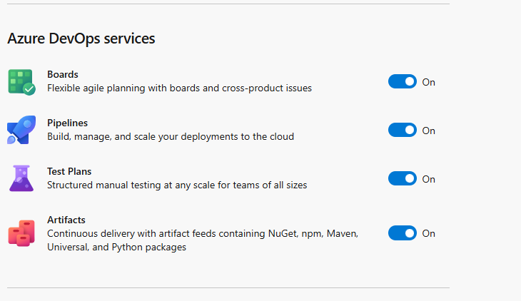

I have been using azure devops from last 3+ years for hosting all of my private repositories. Today I randomly logged in to ADO portal, and I realized I don't see any repositories anymore. In fact, I don't even have the repository service enabled in the ADO. I had 20+ repository under this org, some of these repo's I have still in my local cloned. How can I lose all my git repositories? Any way to get my data back?

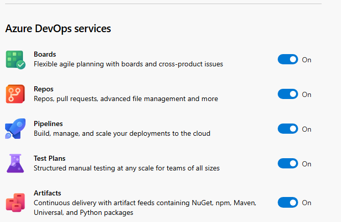

  1. Shiju Samuel 0 Reputation points
    2026-07-03T10:56:19.7566667+00:00
    Thanks for checking this, I left it for some time, checked back after few days. And access to service is restored and I can access my repos, I am the only admin, and same account (local repos wouldn't have synced back otherwise). I am unsure what was the cause. now git pull the locally cloned repos and also see the service enabled back.

    2. Verify That Azure Repos Service Has Not Been Disabled
    Azure DevOps allows repositories to be disabled at the project level. If Azure Repos has been disabled, repositories will not appear in the UI and Git operations can fail. Internal documentation confirms that repositories can be disabled and later re-enabled by a project administrator.
    Navigate to Project Settings.
    Select Repositories.
    Check whether the repository service has been disabled.
    Re-enable it if it has been turned off.

    From the screenshot, two things stand out:
    • The Repos service is not visible/enabled in the project services list.
    git pull returns TF401019, which means the repository either does not exist at that path or your account no longer has permission to access it.
    Please check these in order:

    If Repos is missing for all users/admins and the repos are not visible in deleted/recycle-bin state, I would open an Azure DevOps support case with the organization name, project name, repo names, and the TF401019 error. Do not post private repo URLs or tokens publicly.Hi,
