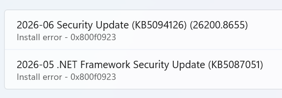

How to fix the hardlock.sys error when updating? Blue screen comes up with error hardlock and page fault in nonpaged area.
I am able to enter the Bitlocker key but I am unsure what to do next. When I can avoid this and log back in the screen freezes within 1-2 minutes.

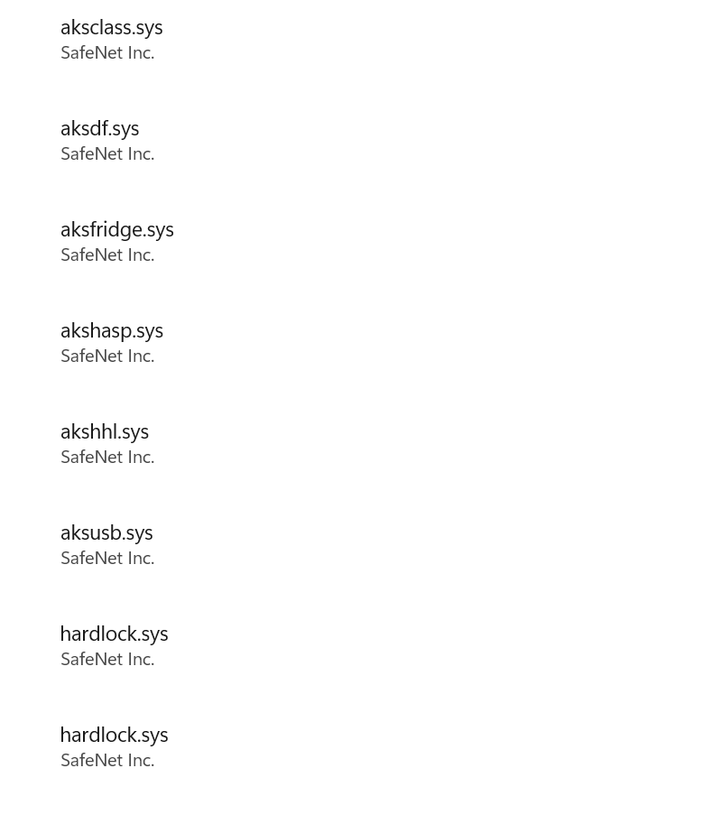

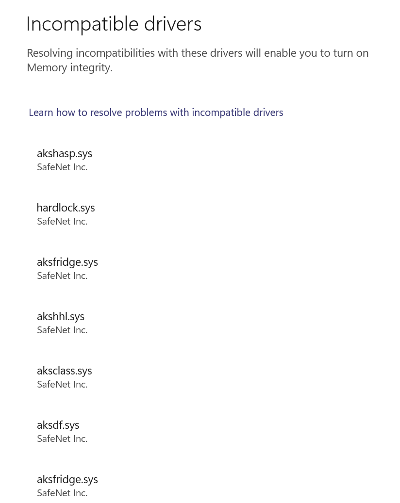

Hardlock.sys is the Sentinel HASP driver, which may be incompatible with Windows 11. The driver is known to cause BSODs, especially during a Feature update.
Are you able to boot into Safe mode? Please see the instructions in the AI response, especially the section "Use Safe Mode or System Restore to roll back changes".
If you can log in to Windows, go to Windows Security → Device security → Core isolation details → Memory integrity. If the page lists any incompatible drivers, please post a screenshot.

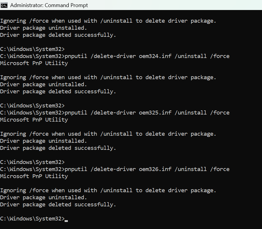

    Thanks for the update. Optionally, please run the commands below to remove the unused ESET drivers.
    From Command Prompt (admin)
    pnputil /delete-driver oem322.inf /uninstall /force
    pnputil /delete-driver oem323.inf /uninstall /force
    pnputil /delete-driver oem324.inf /uninstall /force
    pnputil /delete-driver oem325.inf /uninstall /force
    pnputil /delete-driver oem326.inf /uninstall /force
    Post the output.
