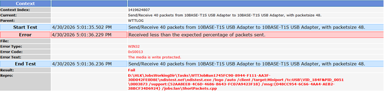

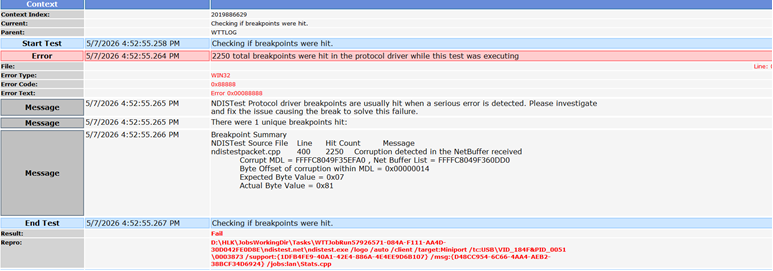

I am running HLK certification tests for a USB Ethernet adapter on Windows 11 25H2. Multiple NDISTest6.5 2-machine tests are failing consistently with two distinct error patterns.
Error Pattern 1 – Breakpoint Hit:
Tests fail with a breakpoint-related error signature. Example: NDISTest6.5 – [2 Machine] – Stats
Error Pattern 2 – Packet Loss:
Tests report: "Received less than the expected percentage of packets sent." Example: NDISTest6.5 – [2 Machine] – ShortPackets
